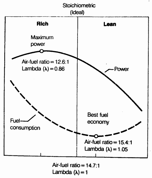

IS this the aim of the 'best fuel map?' to Keep the
AFR at the optimum figure at all times?
or is there conditions where a richer or leaner AFR would be
more ideal?
Optimum for what?
Optimum fuel economy is leaner than optimum power.
Depends on what you are mapping for.
Typcially it will be a bit of both, at different points in the rev range, well on a road car anyway.
Old Nov 22, 2005 | 04:50 PM
a picture speaks a 1000 works

Optimum for what?
i see,
looking at it for gettting optimum performace really..
is it difficult to achieve keeping AFR right (mapping say an L8)
am i right in thinking there are only a rather limited number of mappable points?
(as said know nothing of maps ECUs etc, just trying to grasp somethings ive been wondering about!)

Ideal!! they do speak a lot of words! thanks!
