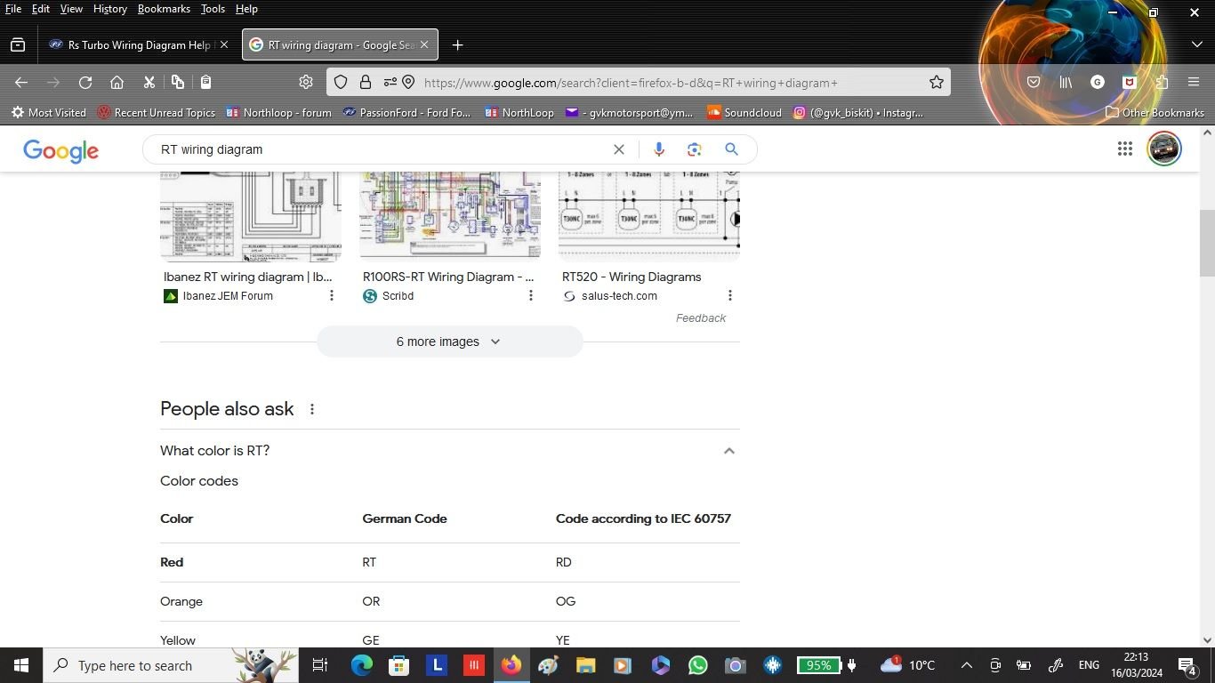

Old Mar 16, 2024 | 10:15 PM
GVK.'s Avatar
GVK.
Joined: Mar 2006
Posts: 4,920
Likes: 128
From: Lincs.
