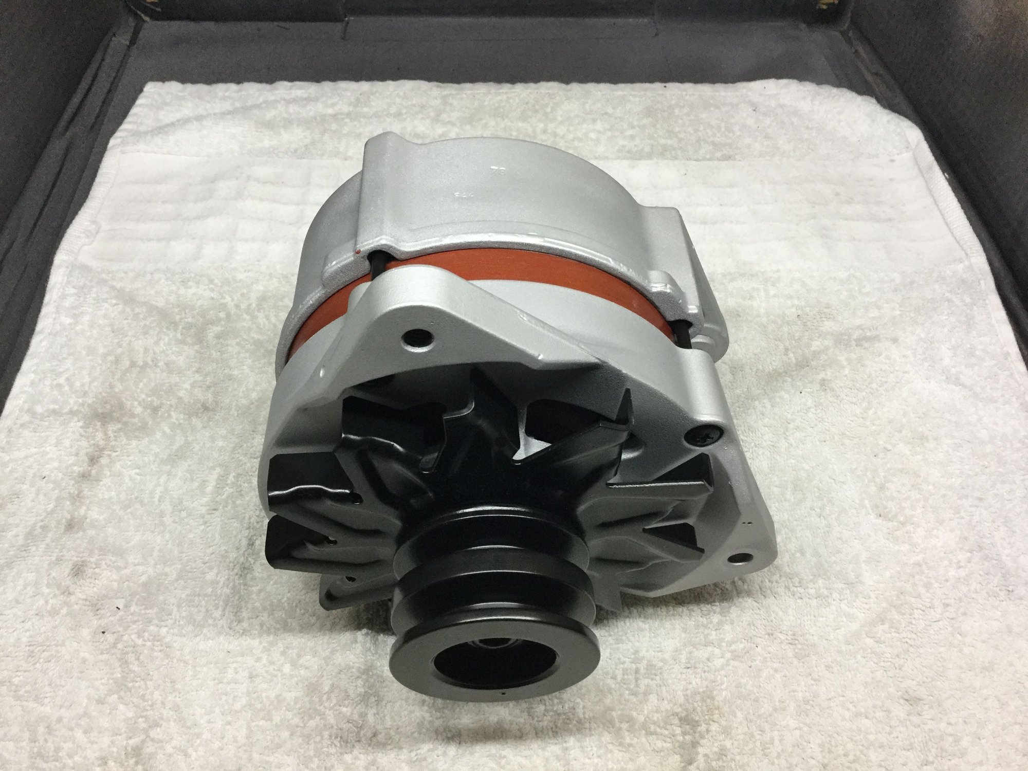

I've used it in past on cosworth inlet ..alternator and gearbox and rear diff mate and it's really good ..im using it now on my s2 built also as I was happy with it before .

That looks nice mate
I just looked it up on YouTube and they recommend an etch primer and there 2k Matt lacquer did you go down this route? If not how does it hold up in the long term as it will end up quite expensive doing it that way.

No mate I etch prime with Halfords etch primer and the aluma blast ..thats all that's needed mate ..and all mine as lasted the lenth of time ..hence thats why I'm happy to keep on using it on the builds.
