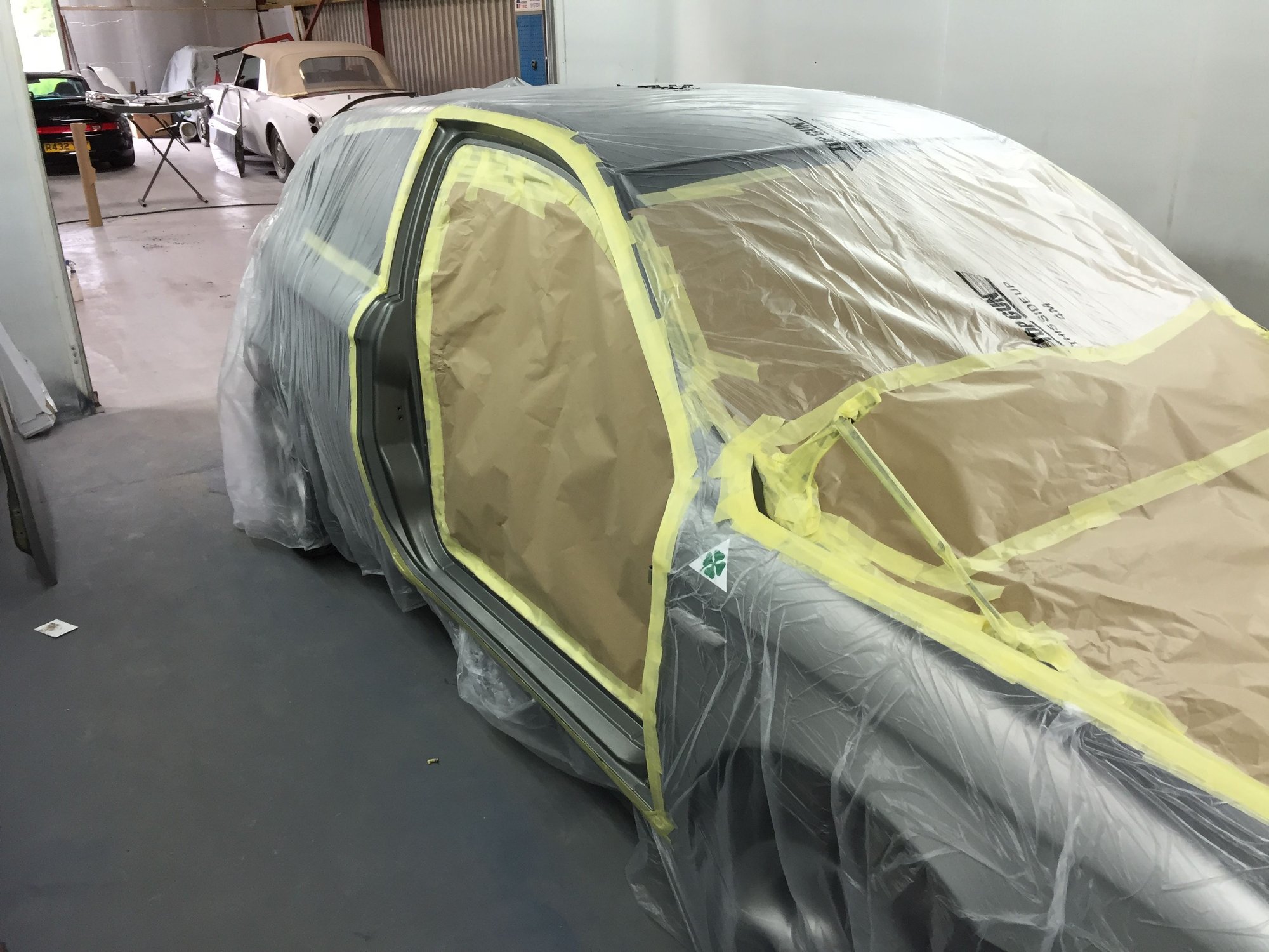

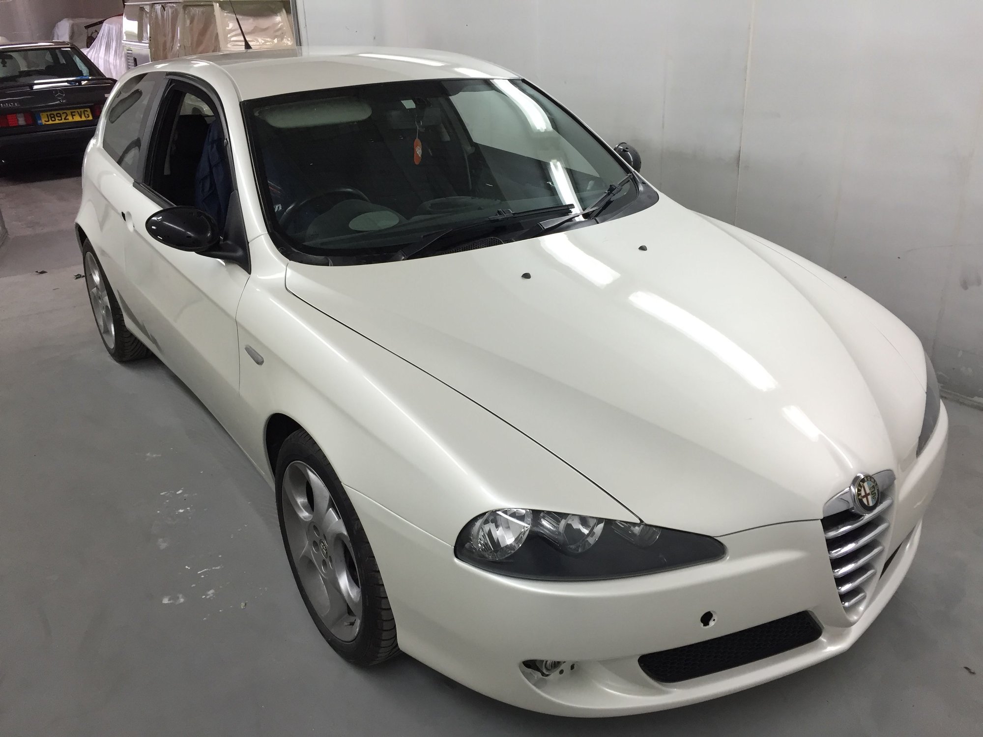

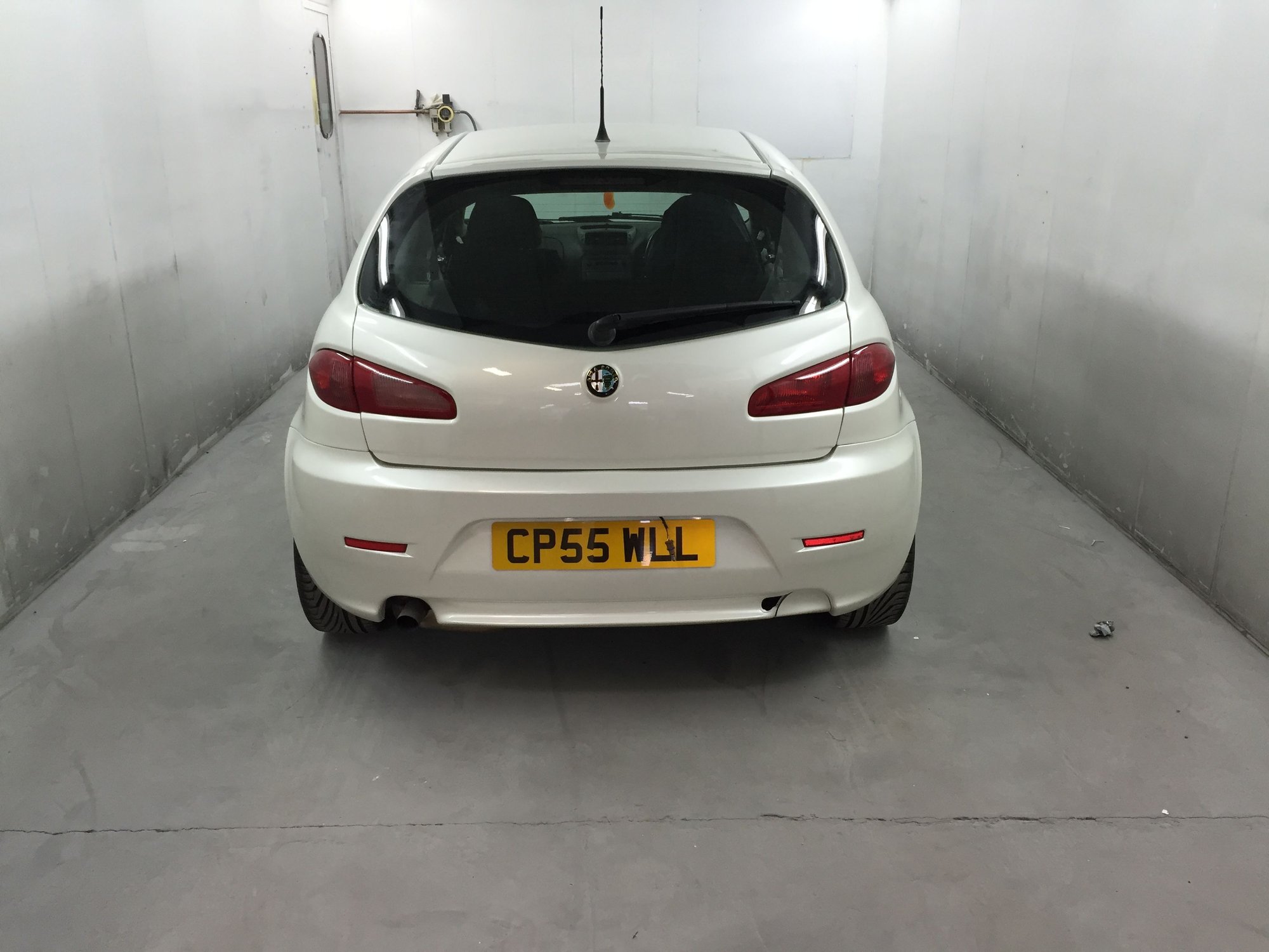

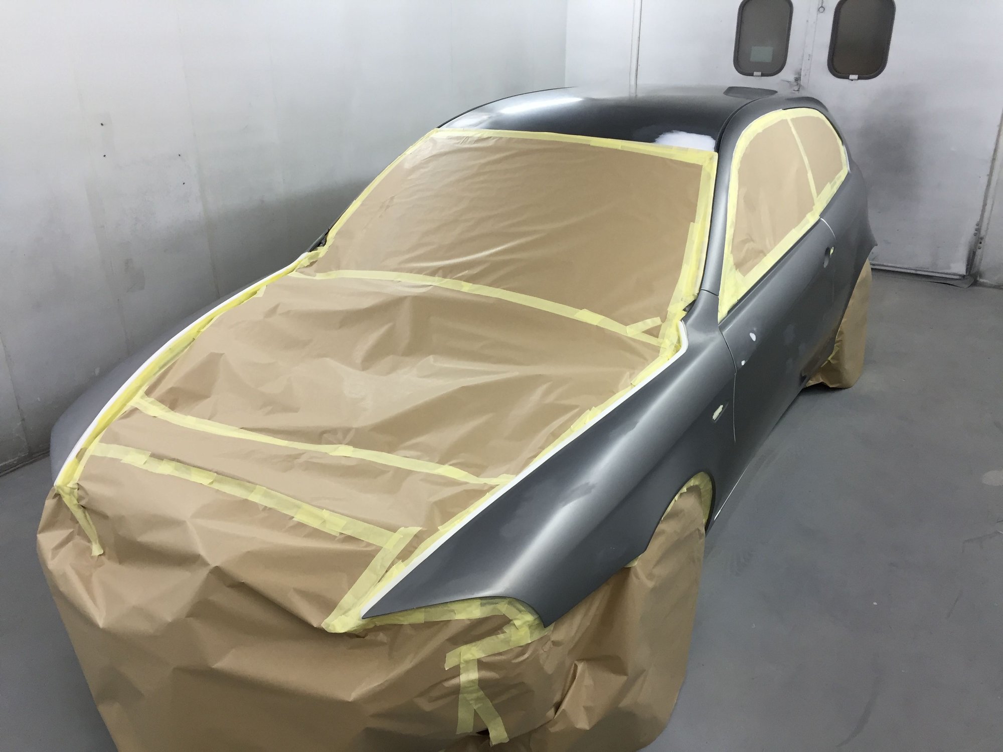

Thanks, I painted last year when I had a bodyshop. It's a 3 stage pearl and an Alfa colour.

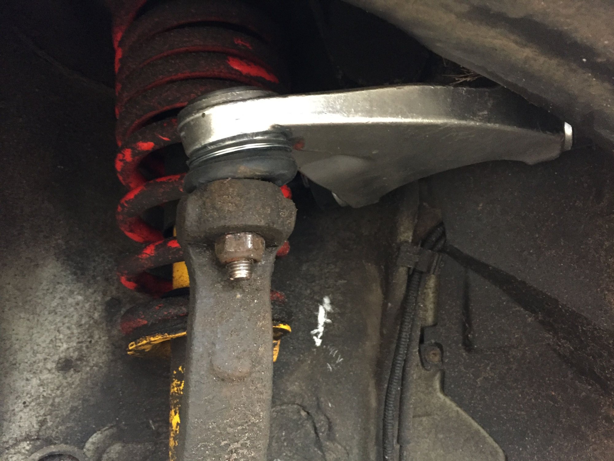

the front suspension are pretty weak. top arms and rods may require replacement each 5-15k mi, depending on the road condition and how raw you're used to drive on 'em. sorry, still donno any upgrade you could make to definitively sort this italian mess out.

Thanks mate. There's something about alfas that get under your skin. You're right about the upper suspension arms, they're made of chocolate you can get poly bushes for them. The engines are strong but like you say they're very sensitive to incorrect oil or over due changes. I use 10/60 fully synthetic and genuine oil filter change every 3-4K and is clean as a whistle.

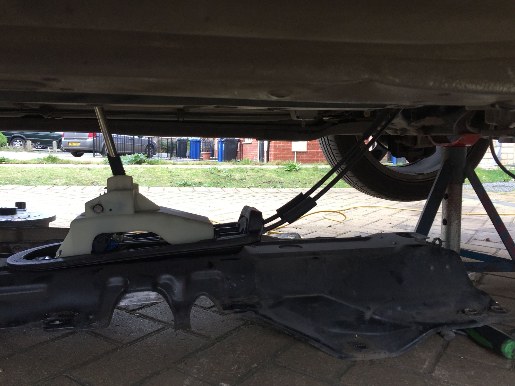

Yesterday I went in balls deep and replaced the gear stick which was badly worn with excessive play which was causing poor gear changes.
Bit of an odd set up, the handbrake and gear stick sit on a platform which bolts to the underneath of the floor. The exhaust runs underneath this platform.
Old gearstick out. It's in a bad state, the grease was dry and the nylon bushes were shot.
New stick. I added extra grease on all of the moving parts.
This is the centralisation/neutral shaft. These have a habit of drying out and wearing out the top hat bushes. When this happens the gear stick won't centralise when in neutral.
New top hat bushes fitted and heavily greased.
All fitted and working super smooth. I also fitted a short shift kit to the selector plate but forgot to get pics. Also fitted a new nylon motorsport knob.

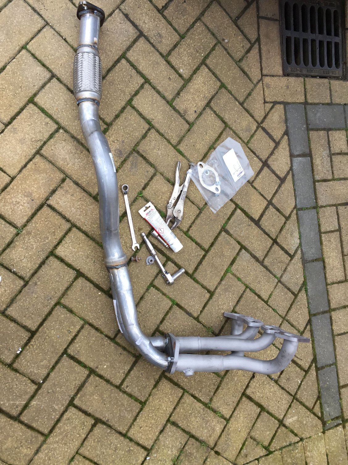

Today I replaced the whole exhaust system and deleted the 3 cats which are very restrictive. First off is an early 156 cf2 exhaust manifold.
I drilled 2 holes for the lambda sensors and removed the heat shield brackets.
Gave it a blast up to get rid of the crud.
This is the original cf3 manifold and pre-carts.
Pre-cats removed. They had seen better days.
New manifold and 156 down pipe.
I heat wrapped the whole system to back box.
Theres noticeably more torque at the bottom of the rev range and is more willing to rev.
