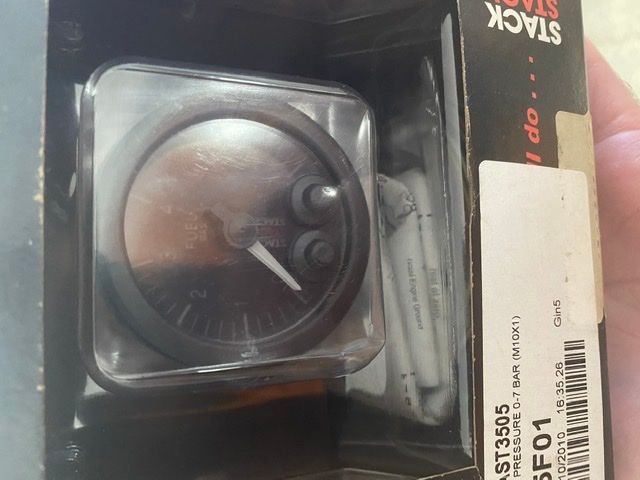

Decided for the new engine build I’d like a fuel pressure gauge
Old May 15, 2020 | 08:28 AM
  #603
Cossy Mike's Avatar
Cossy Mike
Joined: Aug 2007
Posts: 4,136
Likes: 60
From: Tyne and Wear

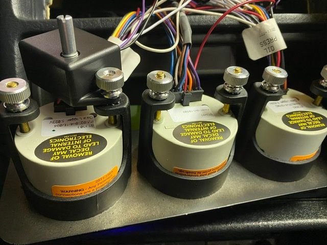

I don’t know if anyone knows but the lighting on the Stack pro control gauges differs from the rest of the range.
standard stack gauges can be seen in daylight with ease and come night time you simply turn lights on to illuminate them.
The stack Pro gauges are tinted and can not be seen unless they are lit up. When they are on standard brighteness they are blinding at night and still a bit too bright during daylight so I had to invest it there stack dimming unit which does work nicely.
I wish I’d of known this before as I’d of simply chosen the standard range, especially the price of them

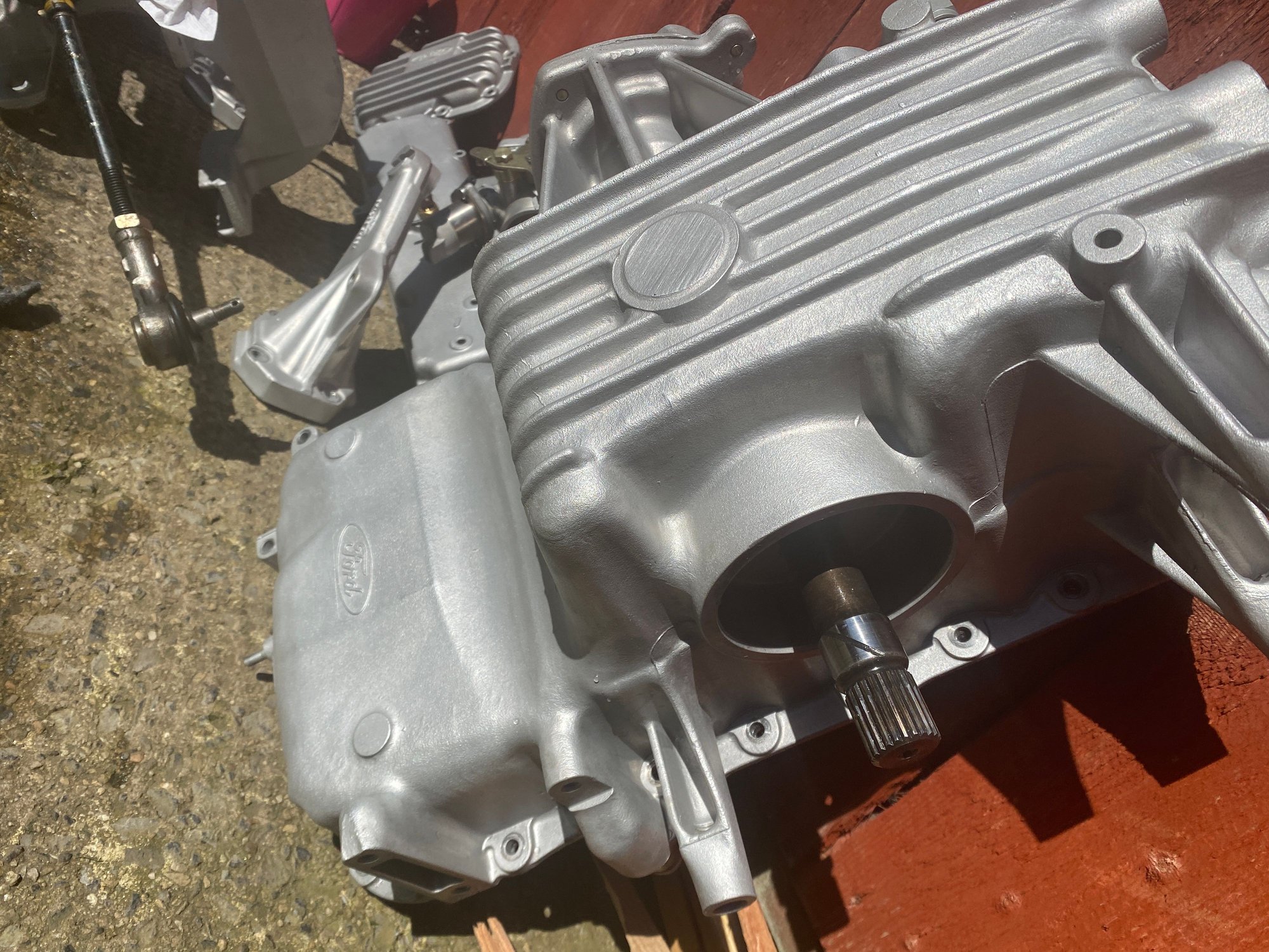

After a few drives out the gearbox started acting up again.
It was jumping out of second gear still, I contacted Pete who said drop it off and he’ll go through it again.
i wasn’t best pleased but if it needed to come out again so be it.

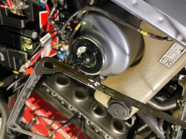

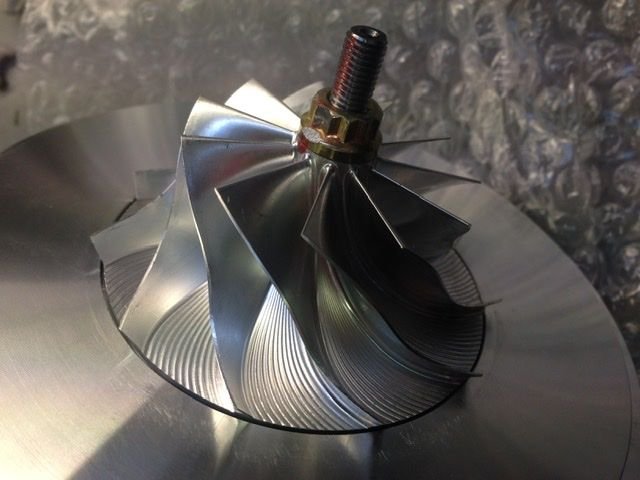

I ordered a brand new turbo core up with billet wheels and refit it on the car.
whilst I was on I ordered up a set of Victor Reinz valve stem oil seals and went ahead and fitted them without removing the head, I don’t wish this job on anyone

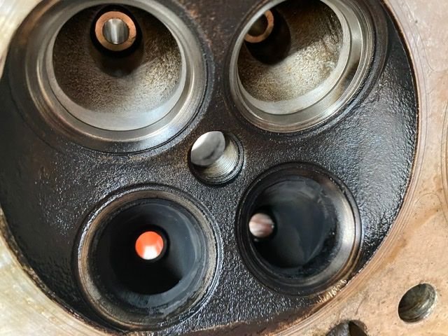

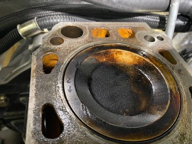

I set about removing the head and disassemble the engine, at this point I’ve decided the head is going off to be done properly, I’m not cutting corners paying cheap twice any more.
I contacted the engine builder and said I wasn’t happy and this has gone on for almost a year and I’ve had little use out of it and would like some
money back as it cost me
Ł110 AB07 cam
Ł90 tappets
Ł80 YB1261 head gasket (which I can’t get anymore)
Ł80 guides
Ł50 oil
genuine EFL90 Ł15
Ł200 cam caps
Ł20 head bolts
and other stuff I can’t think of just now, he gave me Ł180 cash back as that’s what he charged labour.
At no point did he offer to look at it again or rectify it.
On disassemble I found oil starting to collect in the inlet and the new turbo

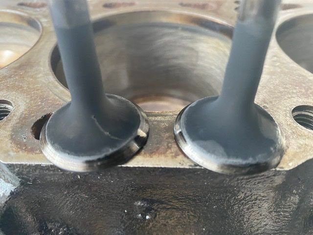

evidence of oil burning on the rear of the valves

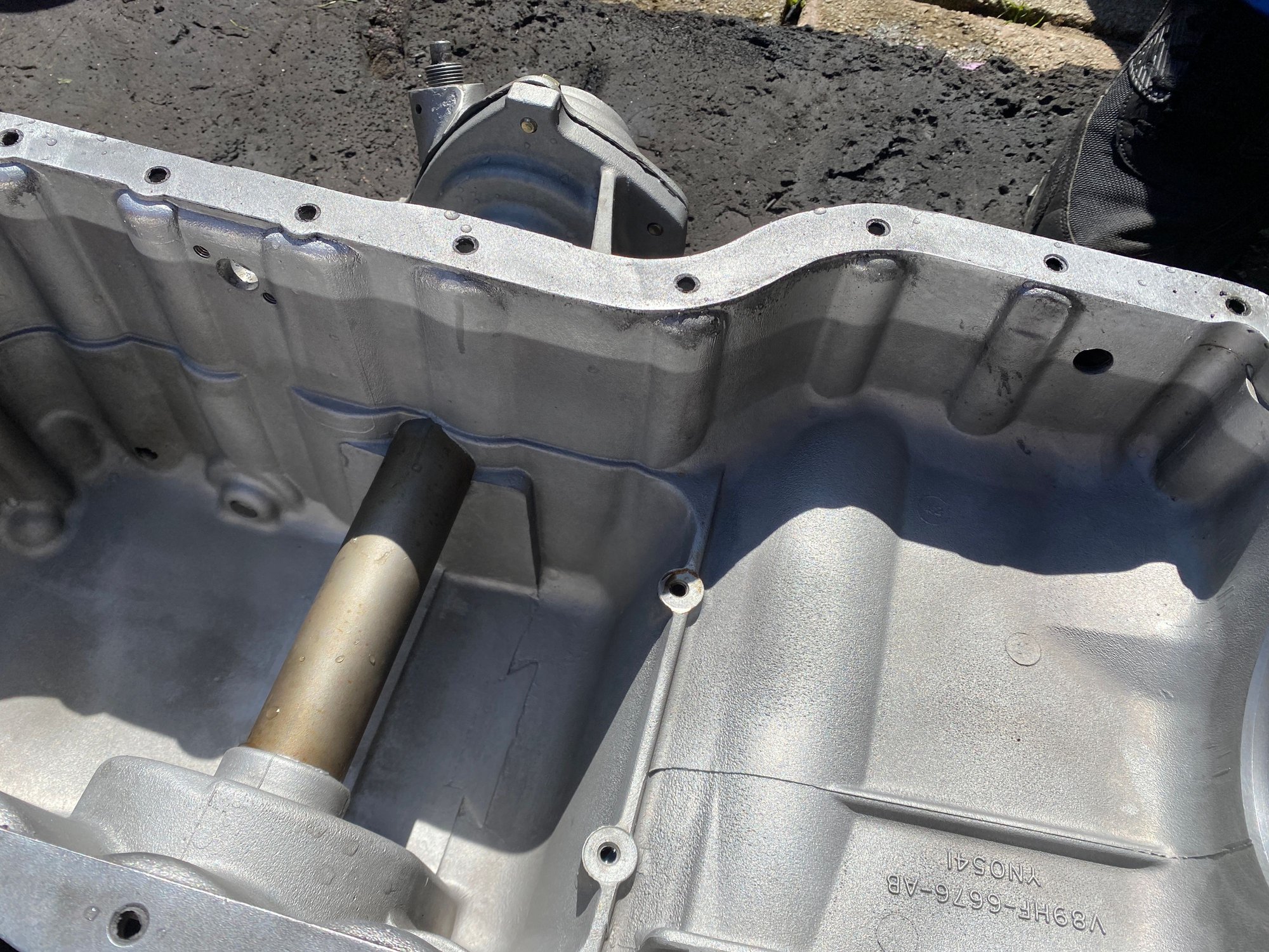

Joined: Jun 2013
Posts: 734
Likes: 93
From: Herts Beds Bucks
Nice oil pump!

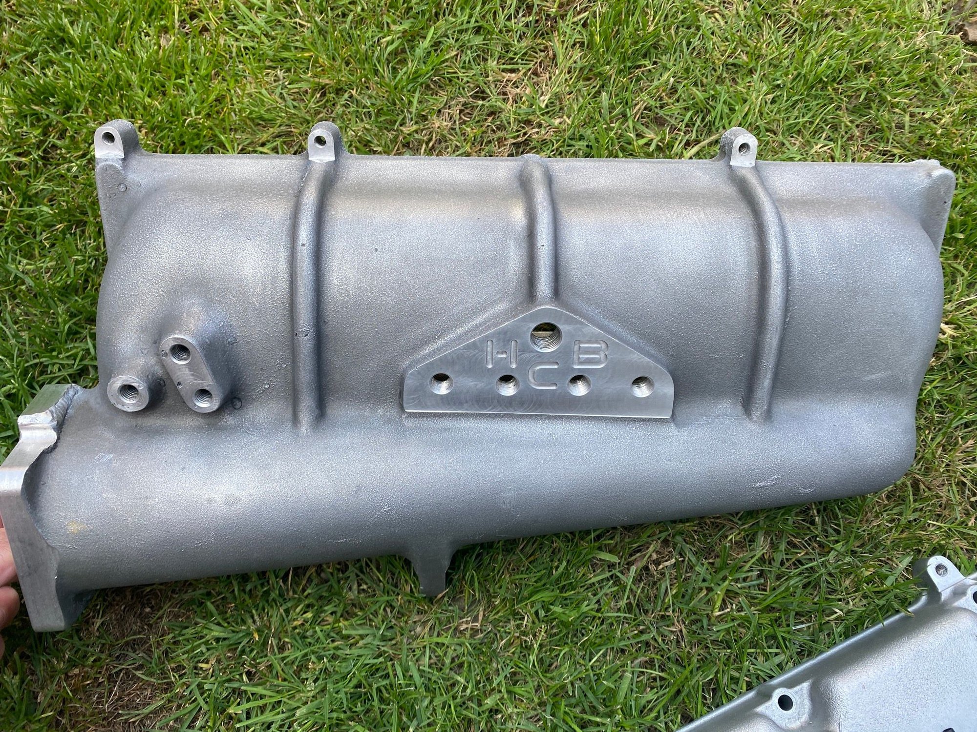

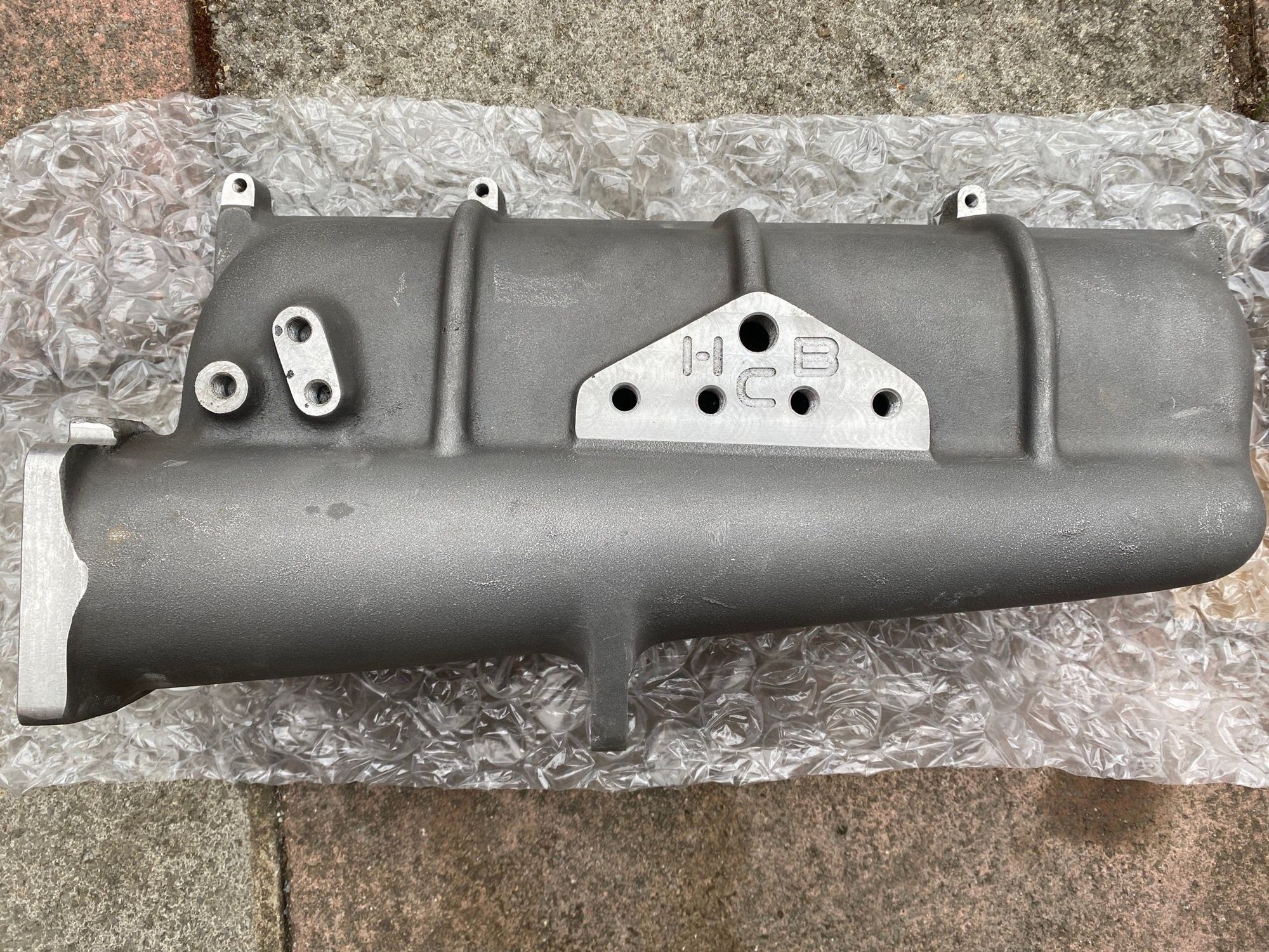

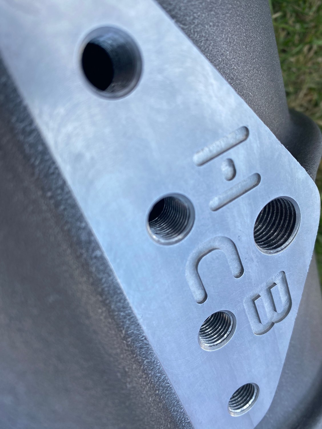

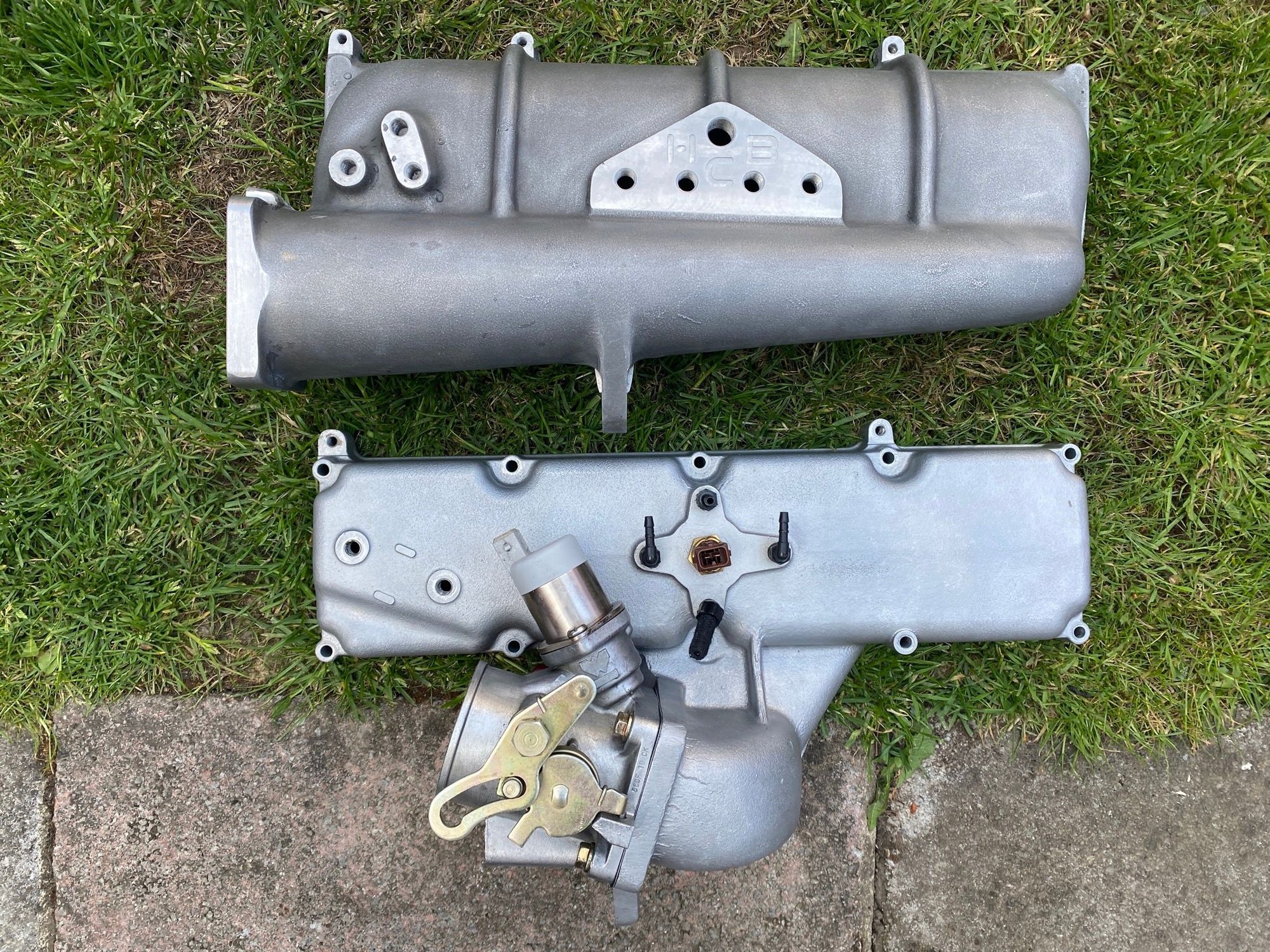

Managed to find a brand new Hart plenum this week,
been sat in someone’s garage for 5 years.
im still undecided what to do with it. Can either leave it the original grey cast or have it vapour blasted so same finish as my 4x4 plenum
Old May 22, 2020 | 09:05 AM

Nice did you get the throttle bracket and the reverse mechanism for the throttle body
Old May 22, 2020 | 09:51 AM
  #629
Cossy Mike's Avatar
Cossy Mike
Joined: Aug 2007
Posts: 4,136
Likes: 60
From: Tyne and Wear
I’ve got a bracket being made next week that should work without reversing it, same design as Jano Oddkids he does for the RS Turbo using Cosworth management with throttle body
can just make it out on the pic
