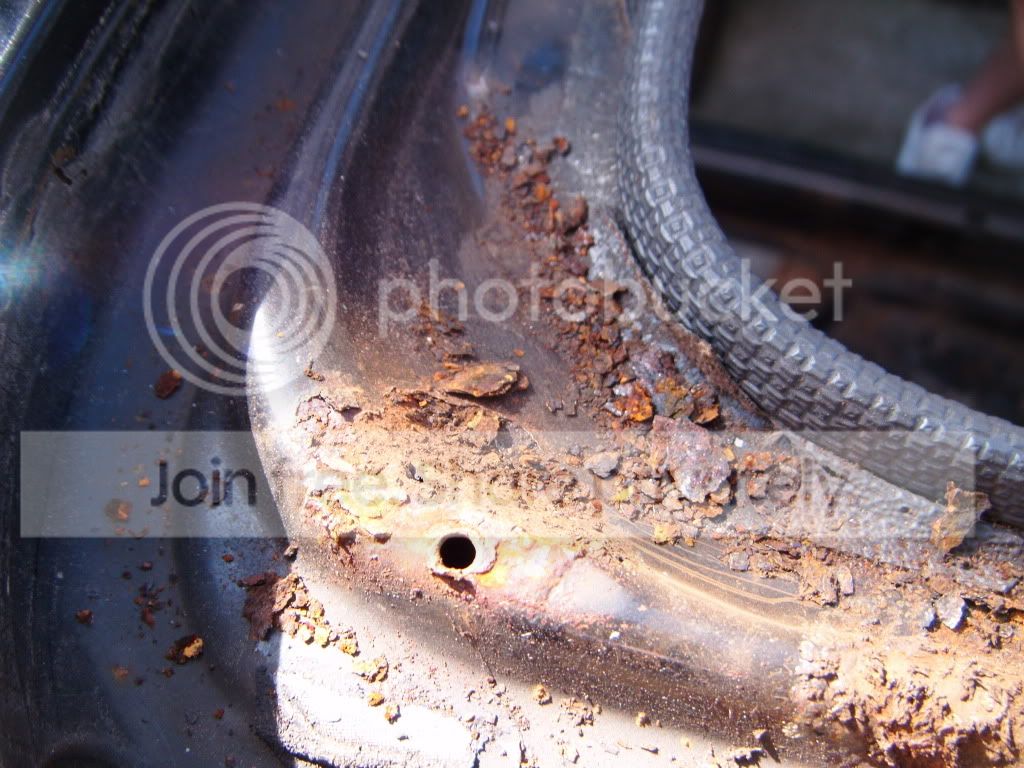

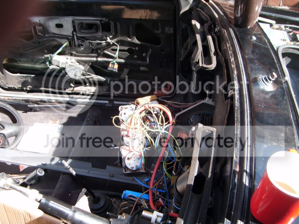

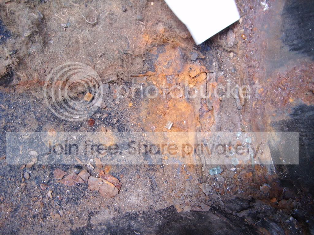

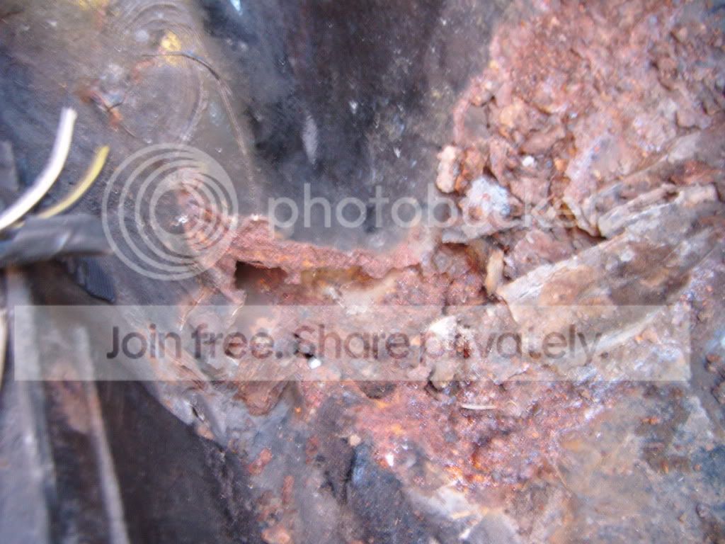

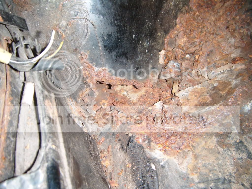

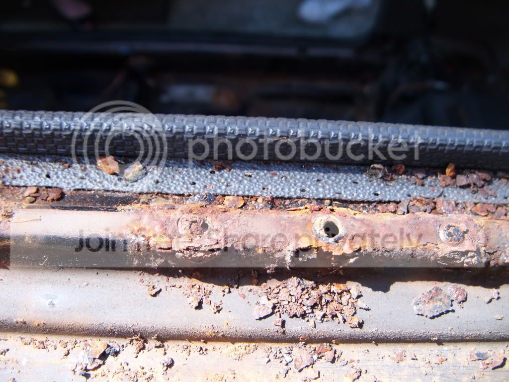

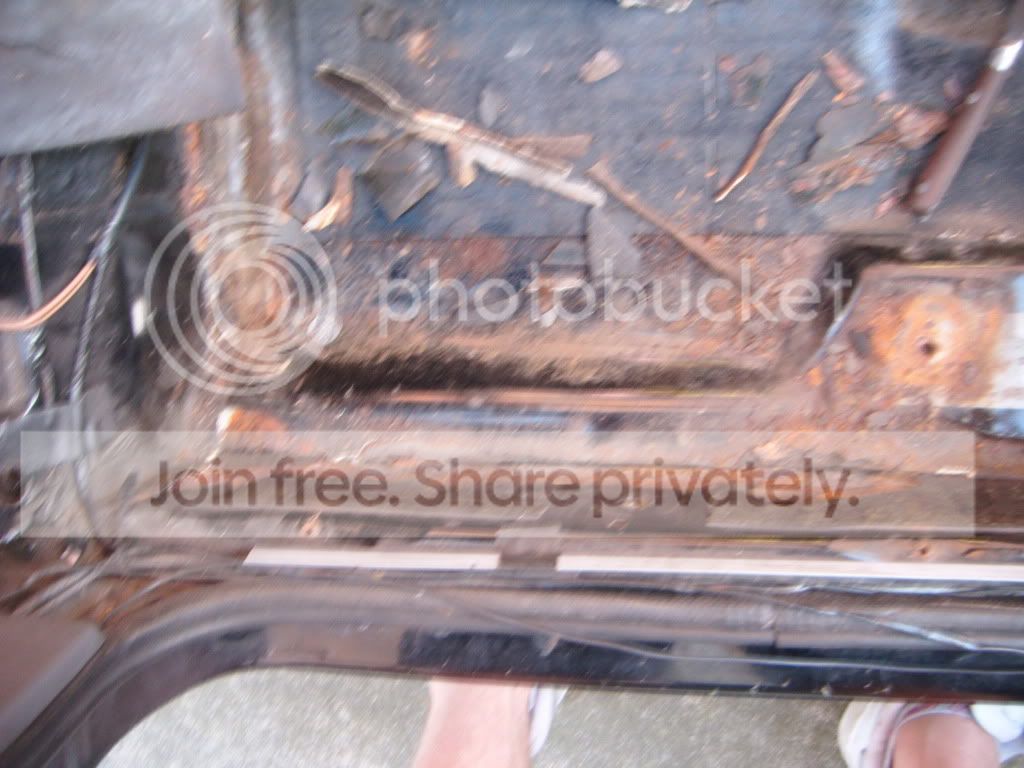

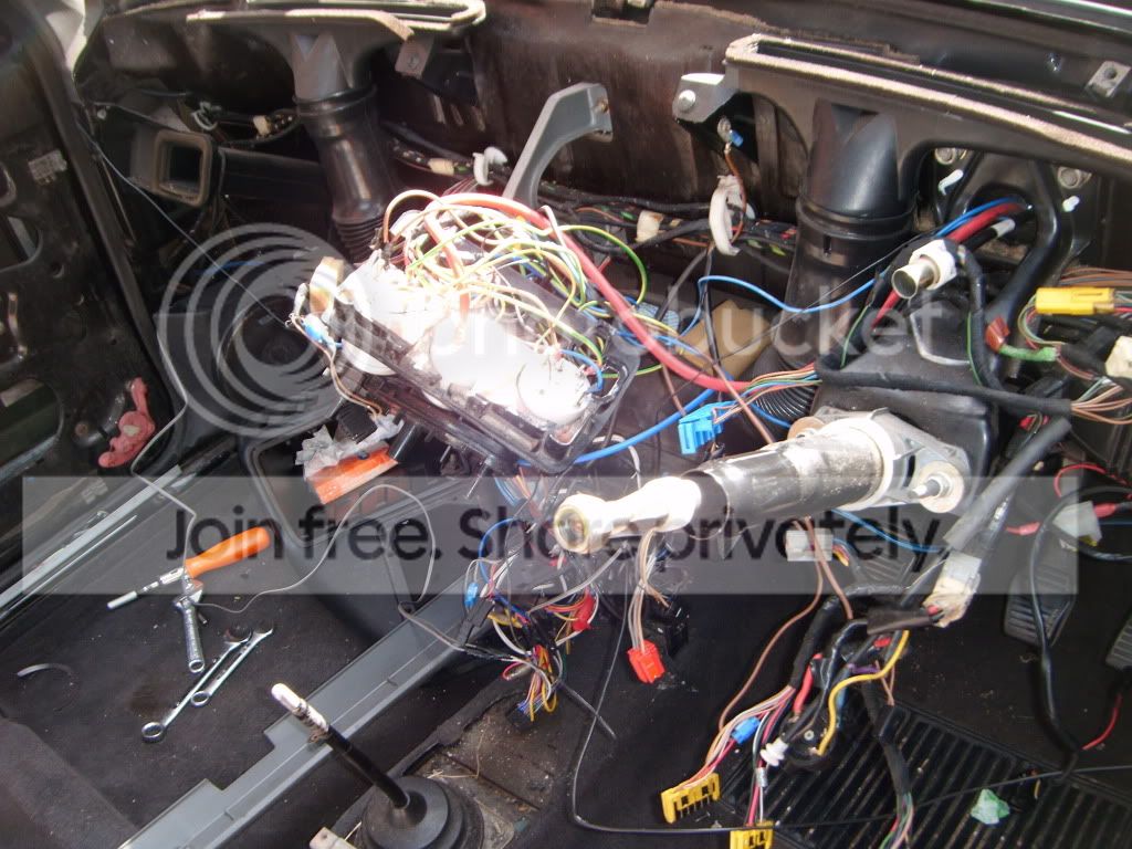

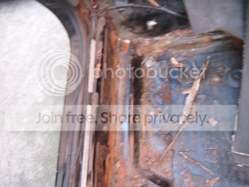

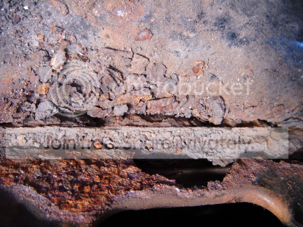

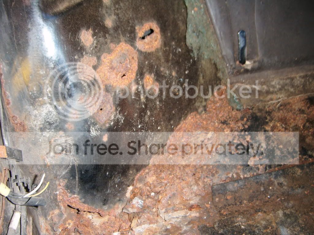

Hi there as you know my black S2 ive been waiting to get it painted and mate of mine (Ferg) suggested we do it ourselves so off we went to the local car paint place and got all the necessary bits and we started stripping her and wel this is the task we have ahead of ourselves
Got a mate coming round to do the welding in a couples of weeks that will be the floor the front and rear windows and bit underneath now i know alot of people would give up at this point but in all fairness ive seen alot worst and it looks worst than it actually is so now i got to source some new bits ie a dash and few other bits :thumbsup
