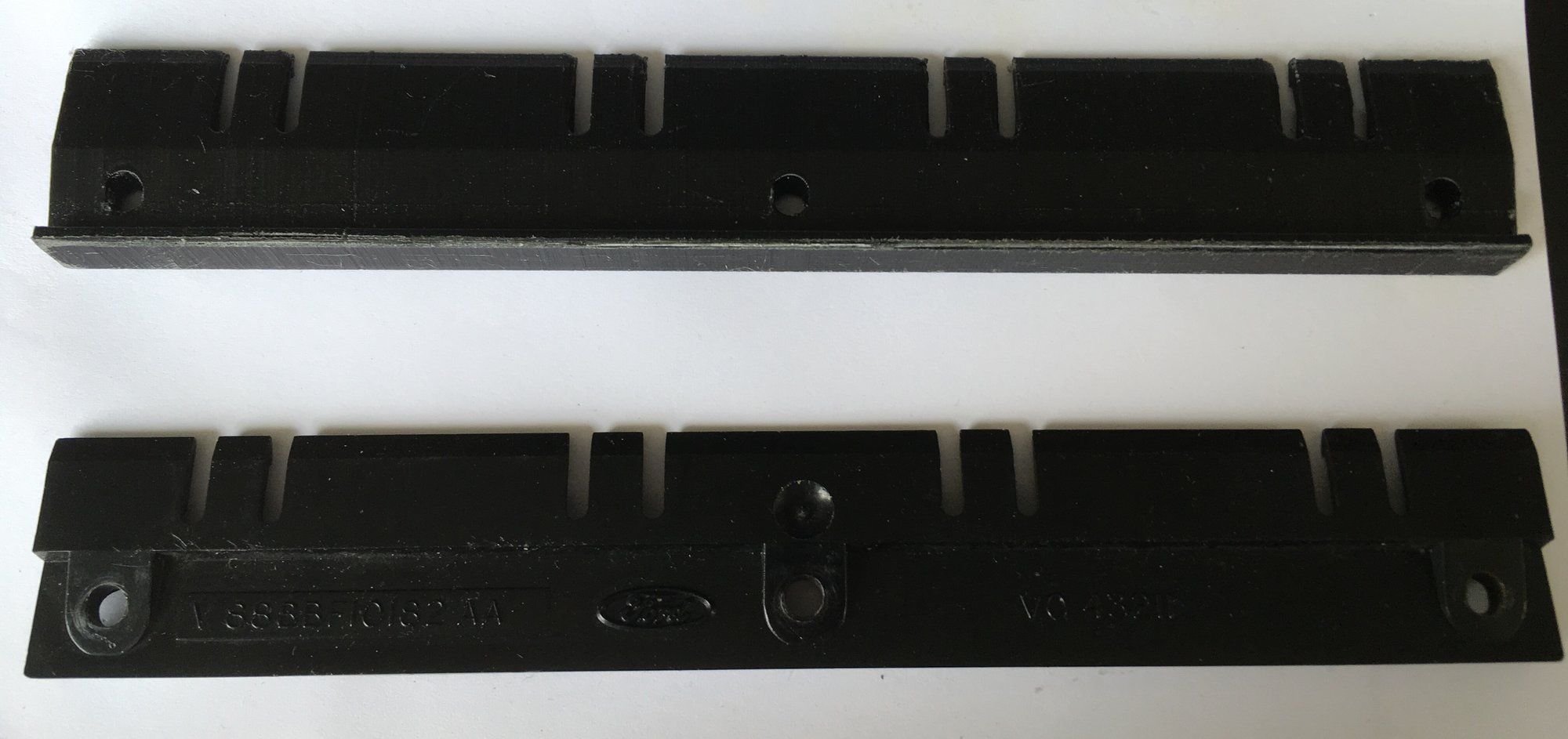

Not updated this for some time. The turbo is still in a box lol but I did get an intercooler fitted in preparation.
Had to cut the inner rear off the headlights to get them back in. But all looking normal an fit right.
Got a 6 deg rear beam so got that fitted, still needs setting up.
Decided to get the sapphire cosworth side skirts to fit back on so made up some sill clips. Did them the same as the ford ones. Then changed my mind and beefed them up a bit as its a trackday car so gets a bit of hammer. New version is far stronger than the ford ones and I made them screw on with captive nuts.
Tried out the ford style rivet on clips on the front small section of the kit. Looks fairly good.
Then fitted the screw on clips to the long skirts.
