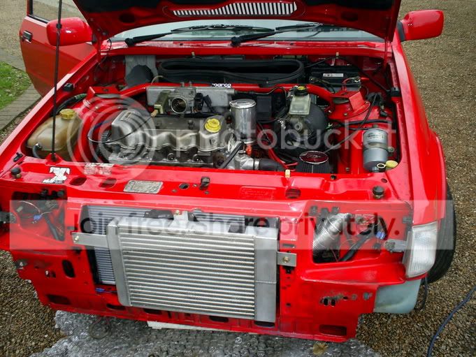

Got a new intercooler and fitted it yesterday, Got two Spal fans with it, where is the best place to put each fan and how do you put the other fan on a new relay? any help would be appreciated
