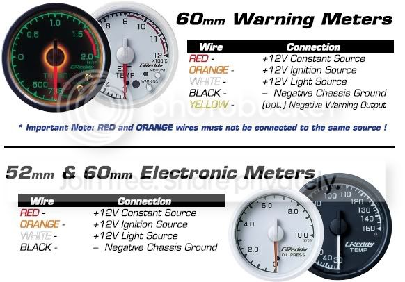

Greddy gauges are a NIGHTMARE to wire up, even more so if you have more than one

dont seem to be too bad,this is what i got!
