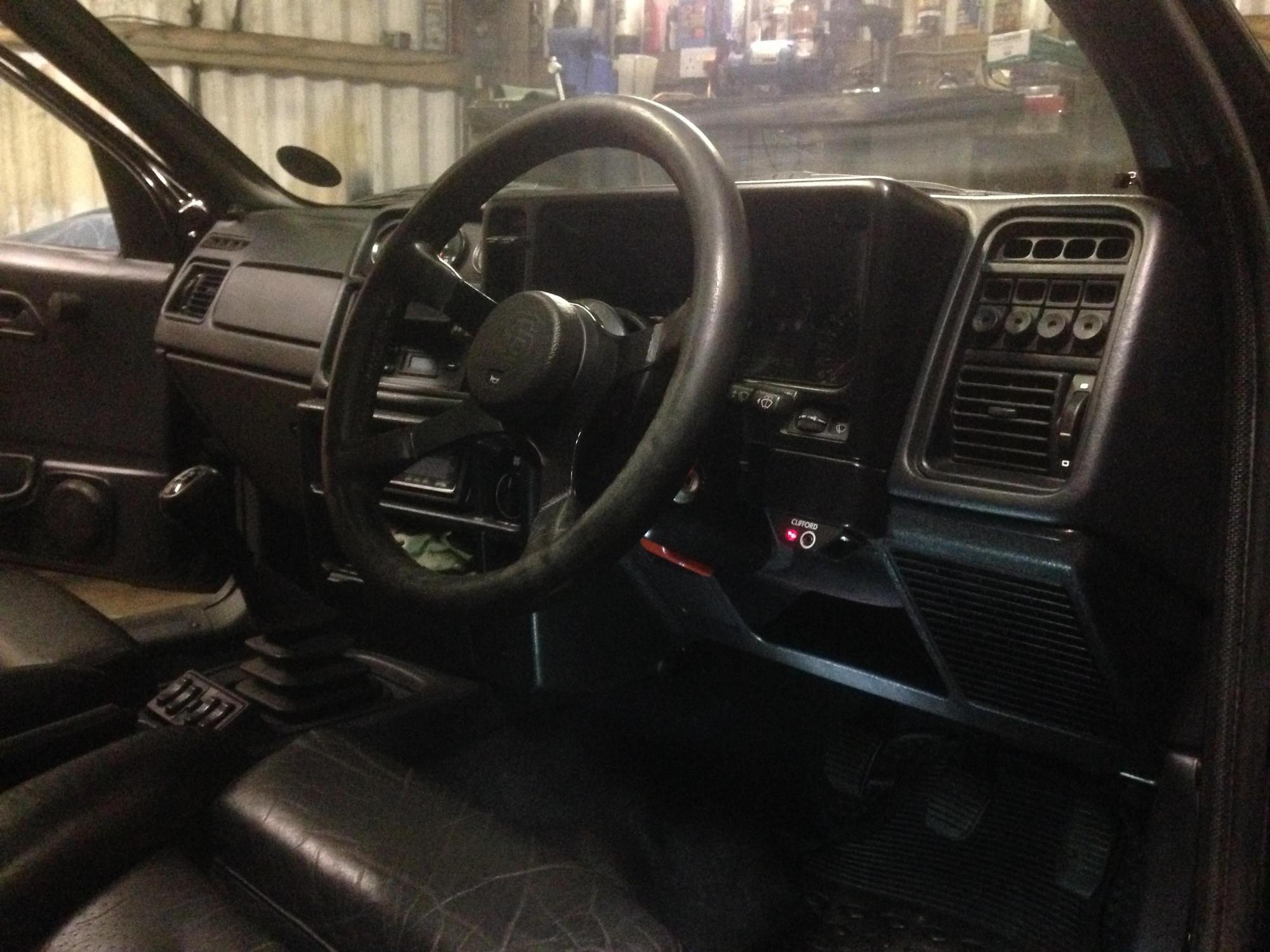

ive started a new thread i accidentally hi jacked lee`s. the crack so far is i thought all 2wd had grey dash with grey cloth seats. mines 2wd 88 e reg the vin says the trim is L . ive got ravern blue dash with the big glove box no speaker next to glove box door. the g/box door is the pull down catch type not squeeze together. i have a red l e d on the top flat surface of the clocks i thought this was sumut some one had put on. the dash has a speaker on the far right drivers side at the bottom next to the drivers door. inbetween the ash tray and the radio theres another compartment where another amp or radio could go. the seats are ravern leather as well with the same colour leather door cards

Look at mine again, has yours got a speaker below the passenger air vent and the big drop down glove box next to it?
Drivers side looks the same. My dash is as it left the factory.
Passenger side has speaker below the air vent and the large drop down glove box just next to it.Is yours the same?
old top no factory l.e.d , small binacle old switches . New bottom , big glove box/lever and big ash tray . Or the inbetween dash pre face lift ie , before big button layoutdifferent binacle .
its deffo not the original interiorRay as I said before, L is shadow cloth on the vin leather is S . Pull the ashtray out have a look at the date code underneath .You also have a look at other plastics and seat belts.

I have a very early 88 car and can tell you that's defo not the og dash in yours
as you say should have the squeeze type glovebox with speaker next to it
no joystick control for stereo just a blank instead
also will have had stereo and amp also fitted
