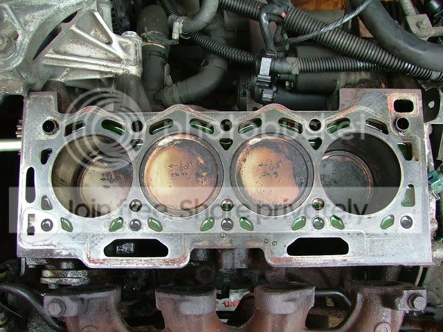

The cambelt tensioner on my g/friends car has spat out its bearings causing the unevitable piston valve contact! Its gunna need 4 new exhaust valves, the inlets look ok Im not sure ifthe guides are bent tho, whats the best way to check? Heres a pic
Also theres some contact marks on the pistons, iwas thinking of just sanding them a bit coz the crank turns ok and theres no marks on the bores, what do you think?
Any advice would be greatly appreciated before we shell out on new bits!

I wouldn't have thought you'd bend guides, take the valve spring off, and see if they slide nice, I'd of thought so, you got to be VERY unlucky to bend guides

I usually just slide down a new valve and give it a rock about to check if its okay. And If it were mine I wouldnt worry about the pistons either. New valves will need lapping in so you should be able to tell from the fine grey line it leaves if they are seating okay
