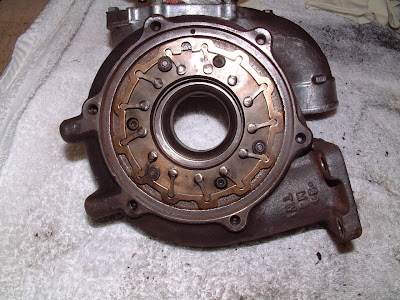

Sounds like turbo over boosting , quite common on the VAG diesels.
There's a ring in the turbo that actuates the variable vanes and they get stuck and cause over boost when driving hard/overtaking etc.
