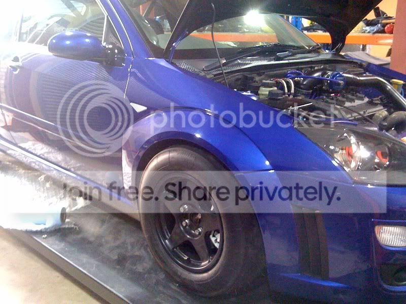

Right bare with me on this please.....
I need some help getting my head round this....
Current wheels run with longer studs and spacers, the wheels are et35 and the spacers are 20mm. The wheel itself is 7j
Now the issue is the 195 50 15 tyre is about 10mm away from shock leg, I want to fit wider tyres on the car. Which are 225 50 15. These are for drag runs only.
To clear shock i need a wheel with a lower offset. Would a et 15 with 20mm spacer sort the issue? Or would going upto a wider rim 8j or 9j help at all.

since these are for drag racing it doesnt make a difference if they come past the wheel arch and because its fwd the suspension wont compress down then launching.
if you currently have 10mm of room going up to a 225 tyre may cause an issue as you have gained 30mm of tread, or 15mm towards your suspension.
your options are to run the tyres on your 7j rims, this is fine because your going in a straight line, not cornering. if you do use this wheels, run a 15mm spacer on it and you will in have the same amount of room you originally had.
This makes the assumption that the closest part to the suspension was the upper edge of the tyre and not the part where the tyre meets the rim.
can you be specific on where the closest point is and we can advise further

Will slip the tyre on the spare rims tomorrow then get it on the car.
Then this should highlight the exact contact point and extra spacing needed.
