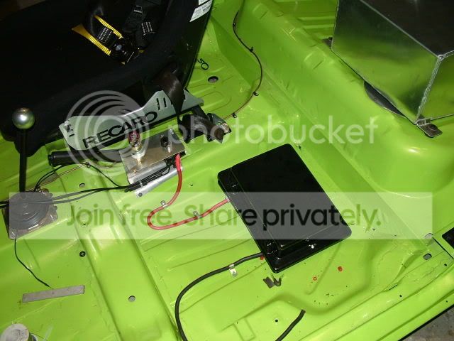

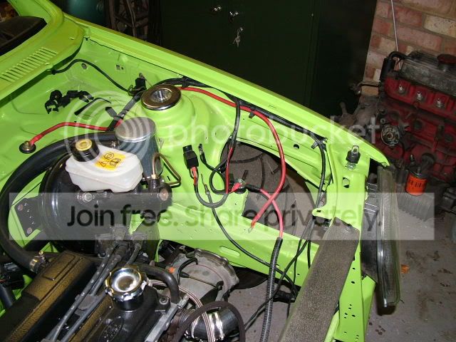

Ive got a Varley Redtop in a Burton battery box with cut out close by. You can also see the through-panel battery terminal used on the bulkhead. The battery cable leads to the front inner wing where all the original cables meet, ie starter motor and power feeds into the loom. Its all insulated from the body by a cotton reel rubber block.
