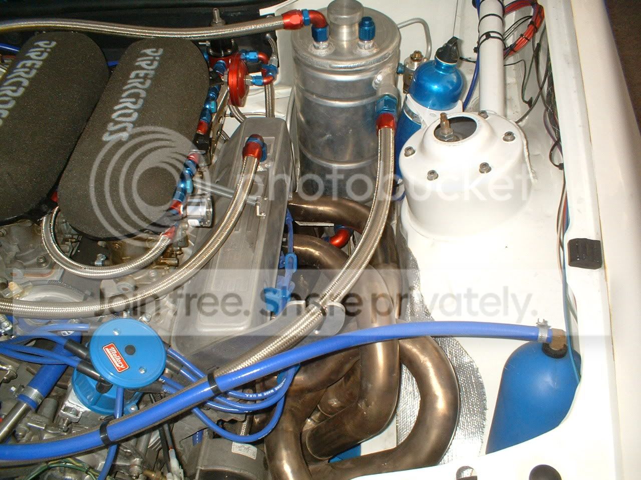

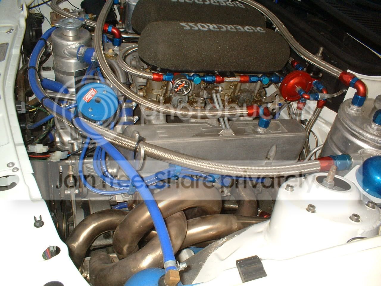

Originally Posted by jaycos
aint there a lad that uses pf who has a tvr in a saff thats stupid
Heres some old pics dont know if any thing has changed since
A pic of the cage (not a great pic )
Like jim said tho if your going to do it do it properly and go the full hog
