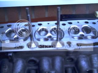

has anybody got the torque settings for arp long stud head bolts and 6 nuts?needed asap.iam using a ferriday gasket and coopers rings if that makes a difference.

well its on , 95 ftlbs.tight as it seems to want to go

are they long studs like wrc or just studs that replace the head bolts
ive got some new arp studs somewhere in the box i can dig them out if these are the ones?

arp 6 long studs mate.head is back on now torqed to 95 ftlbs.

ok mate
just got them out
arp say torque to 81 ftlb with arp moly assembly lubricant
or
torque to 105 ftlb with 30wt oil
