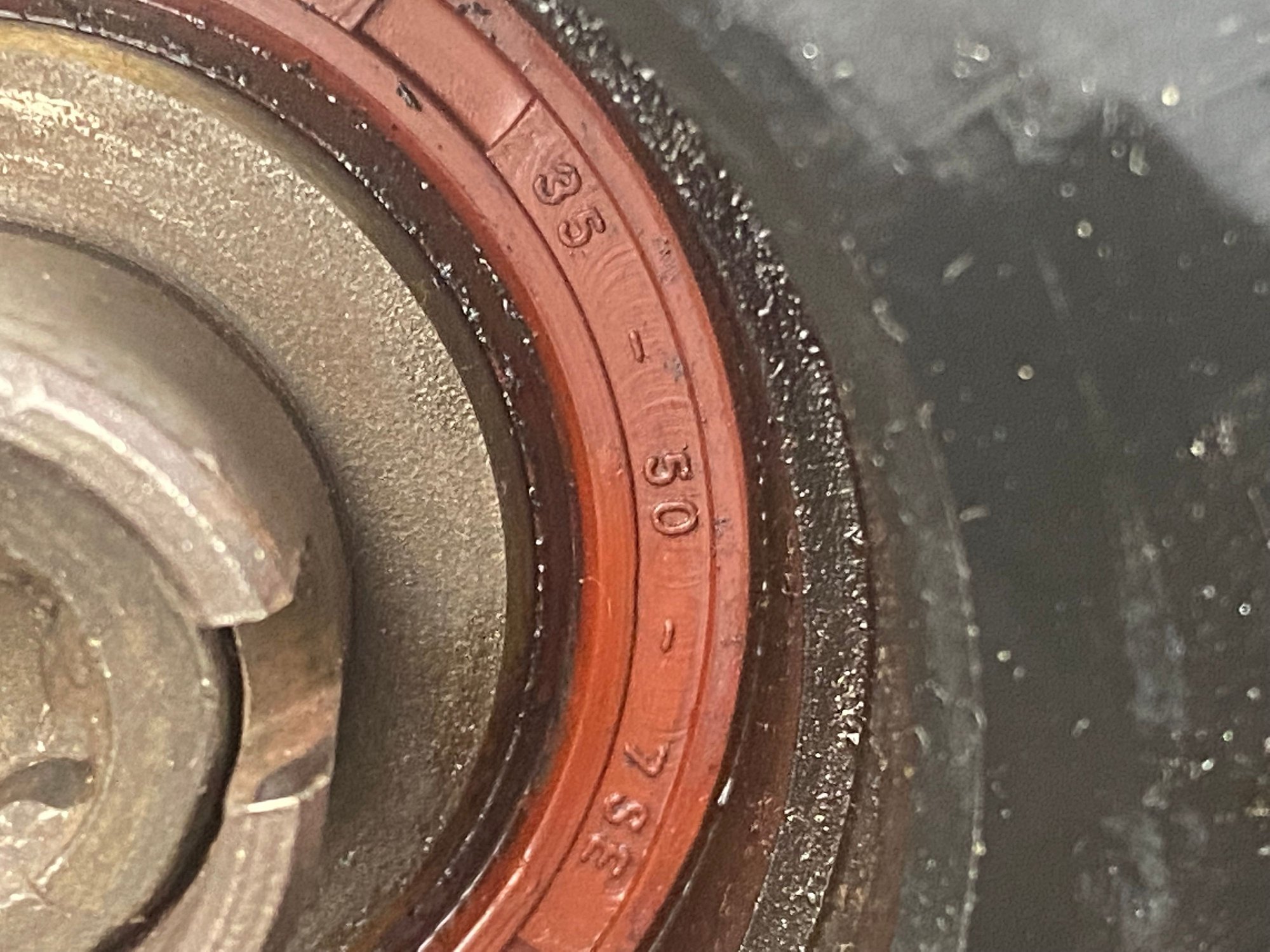

Also, I managed to find the correct cam (ignition distributor side) seal 35 - 50 - 7SE at last as the last 3 online purchases were incorrectly defined as suitable by the Ebay sellers who either sent larger or smaller types. The current seal is weeping as evident with the oily residue but will be sorted out once the new seal arrives in the next few days.

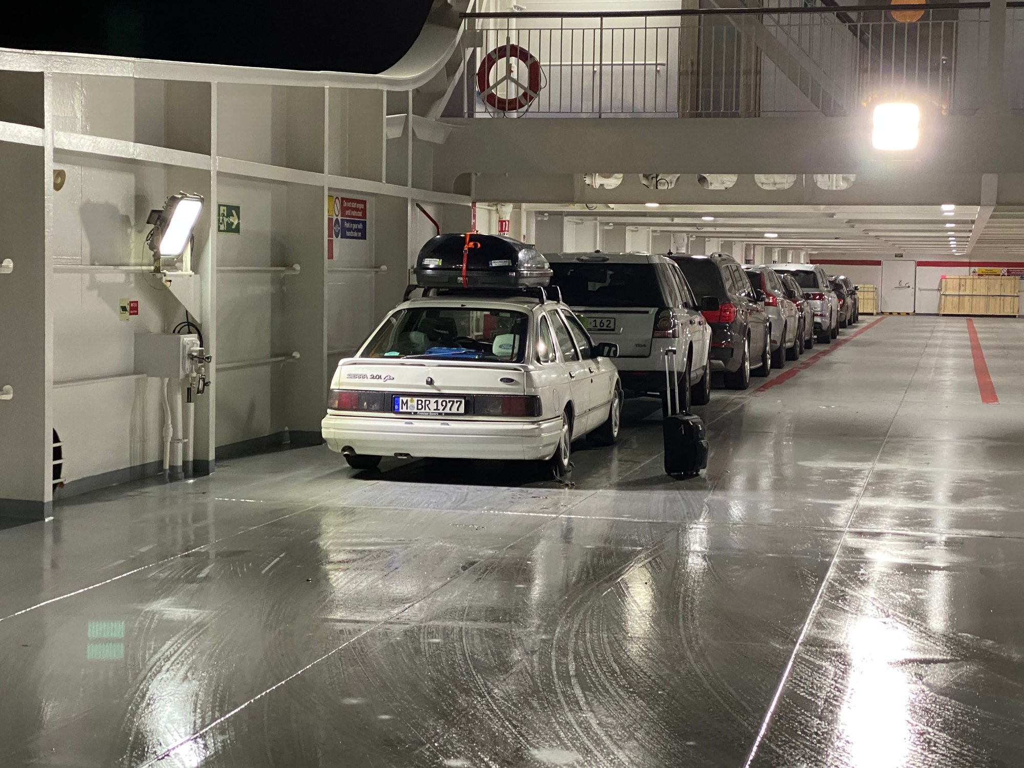

Having a 40 mm drop while driving back 2200km in Feb to Bavaria by way of Irish Ferries involved a pretty packed car snagging the exhaust on the up-ramp of the Ferry resulting in a broken stud on the exhaust manifold and broken gasket. A 12 hour drive straight to Bavaria with a broken exhaust was not fun. Thankfully the noise cancelling SONY headphones were a lifesaver.

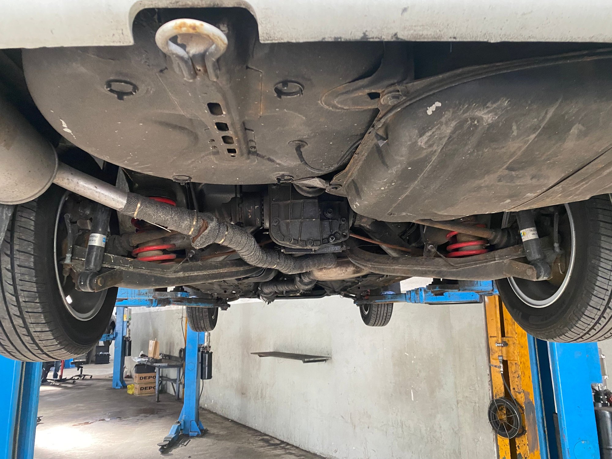

Replacement Donut bush, center prop bearing, and gearbox mount bush.
Exhaust wrapped, rear differential serviced, and lowered coil springs that will be swapped back out for standard.
