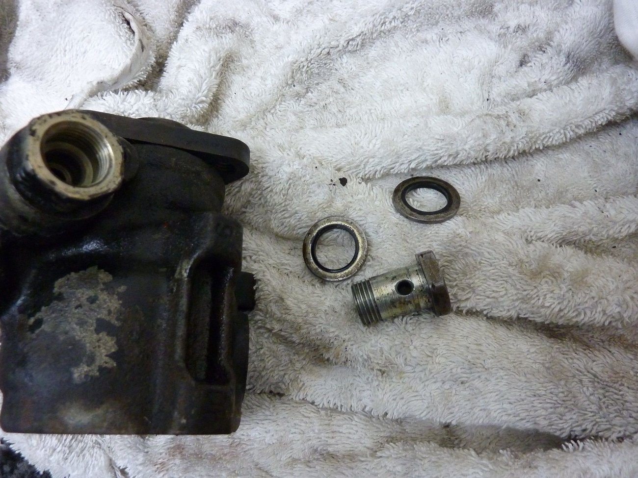

anyone know the size of the banjo fitting that bolts to the powersteering pump unit?
broke my pipe when removing
so want to make up a new one.

from memory M16x1,5 I'll check this morning..

just checked totally forget this one.
It's 100% sure M16x1,5
