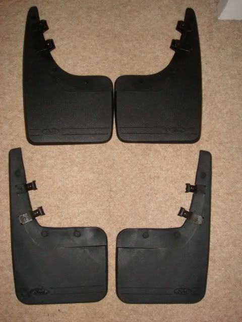

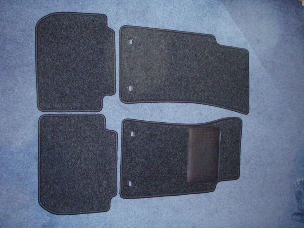

Just thought i'd post this up as it may interest a few of you
I decided i wanted some flaps for the sapph, so looked into getting genuine ford ones. They don't list any specifically for the Cosworth so i took a chance and ordered some up.
Mats (FINIS 5027658)
Flaps (FINIS 5016699 front, 5016700 rear)

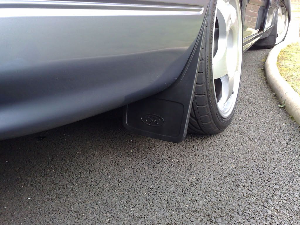

The rears fitted perfectly.

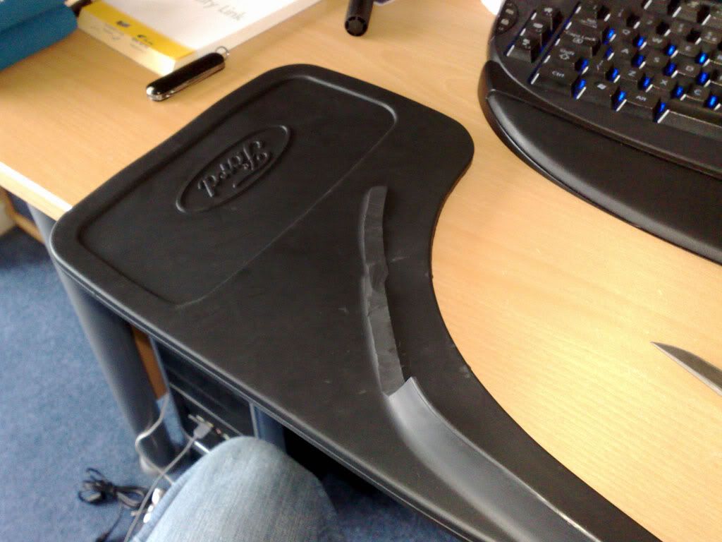

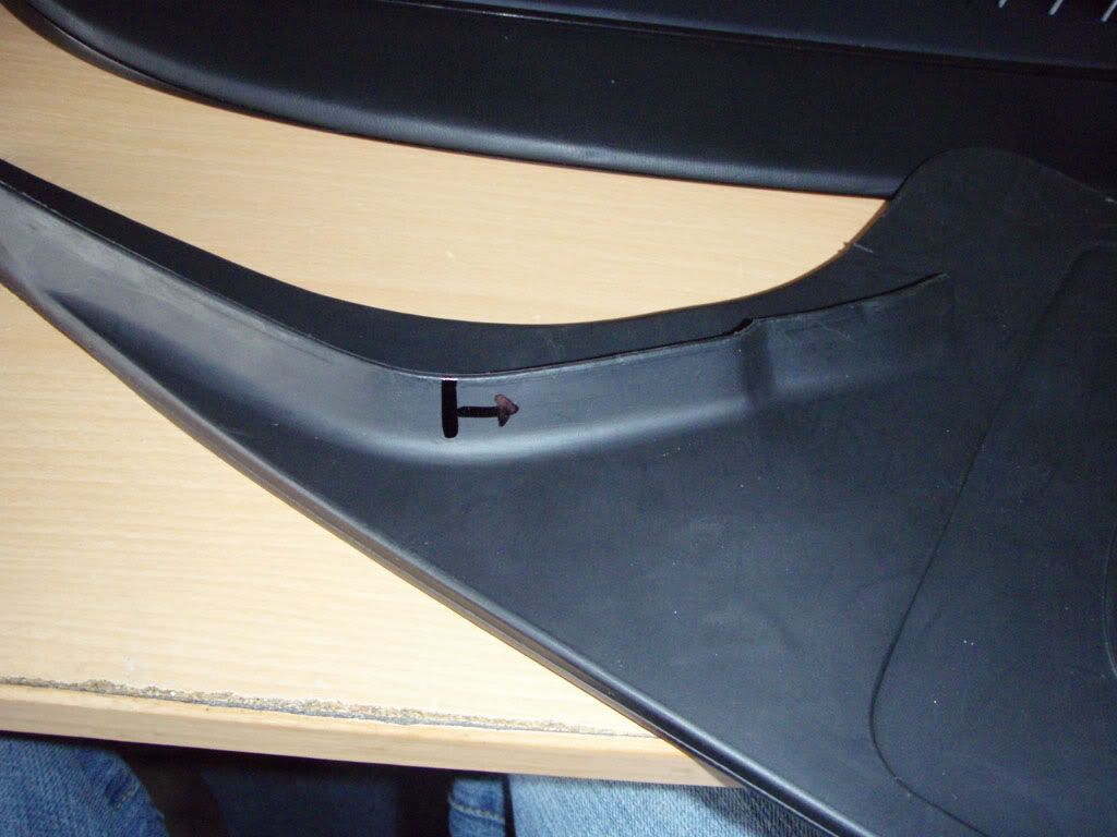

The fronts were a different story though
They are moulded to the shape of a Sierra wing, but the Cosworth sideskirts get in the way of the moulded section. Mocked one of the front flaps up and had a good look at what was getting in the way. I then realised it was going to be easy to make them fit
So it was out with the knives
I need to trim roughly this much off-
Trimmage
Didn't cut myself either, which was surprising

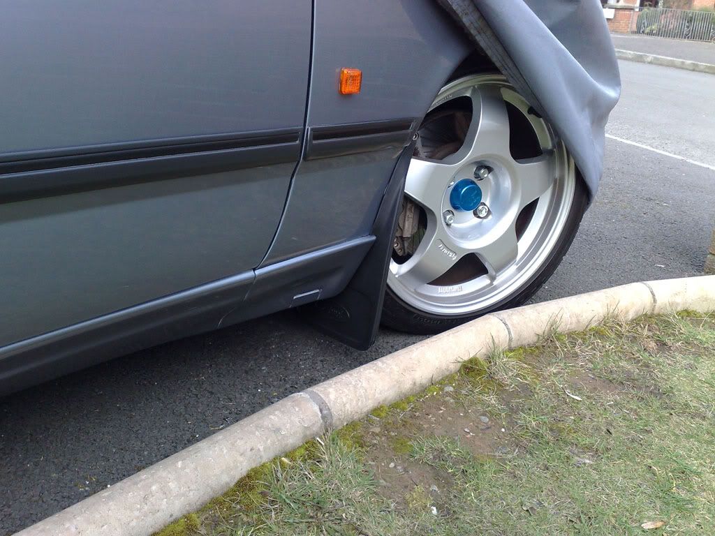

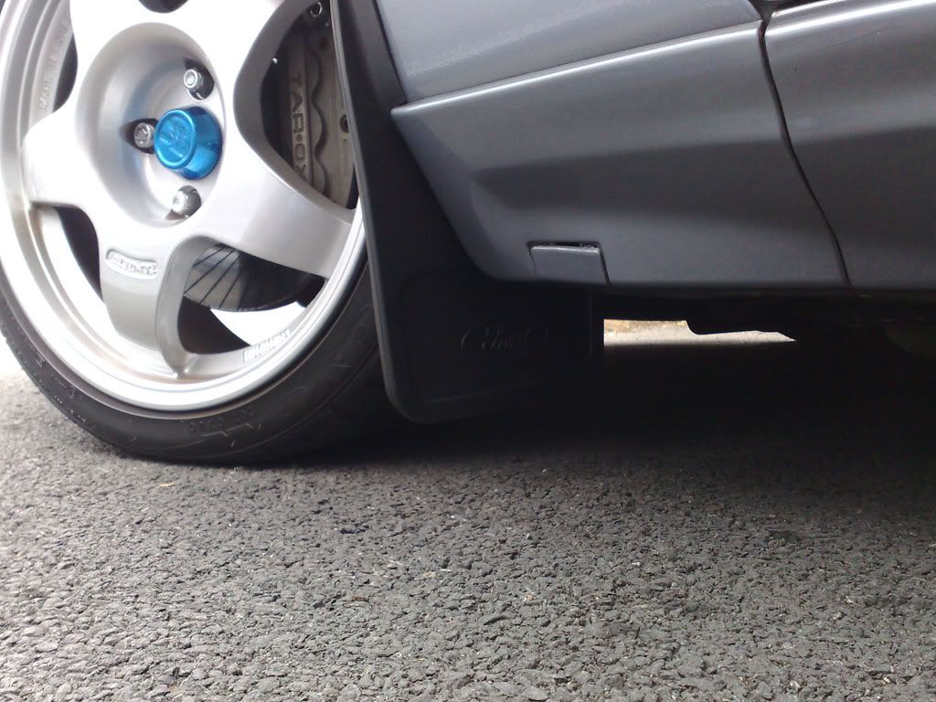

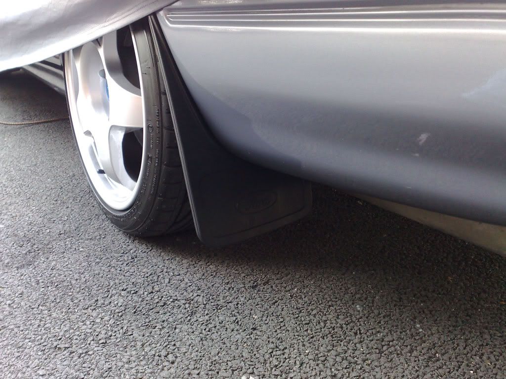

Fitted. They needed a few slivers whacked off to make them sit perfectly, but it was no big hassle.
Have to get some better pics, didn't want to take the cover off as it was starting to rain

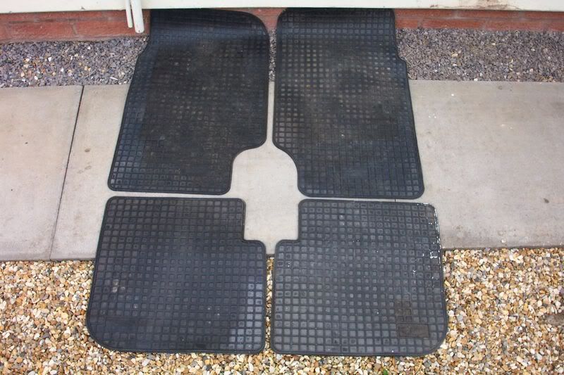

Does anyone know if the front rubber mats are still available, the ones with little indented squares
I would buy a used good set if they are nla and anyone wants to sell them
these ones

I think the rubber mats are still avalible. I believe my mate asked about them for his 3 door. I'll check and get back to you.

Hello, i just asked trevor at ford parts about the rubber mats and also for the carpet ones.
This is his reply :-
The MK1 Sierra Front Rubber Floor mats are the same as the MK2
and not listed different for the Cossy and are available (5015540)
Rear Rubber Mats are obsolete though.
Ford did not offer carpet mats for the MK1
But if the front rubber mats are the same we can assume that the MK2 Carpet mats would fit
Again no specific mats for the Cossy listed
Grey Standard Carpet Mats Sierra (87-93) (5027658)
The rubber ones from ford are about Ł14 plus vat. The carpet ones are Ł18 plus vat
Hope this helps

These are the genuine mats and are the same as a lesser Sierra as we have them in ours which is completly orginal and came with them when new (Hence why he dosen't have a Cosworth listing), I have also seen them in Cosworth's that are original and so there was although sadly mine hasen't.

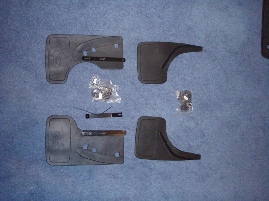

ok, the below photo
top is 5022356 -Premium front
bottom is 5022357 - Premium rear
Old Mar 4, 2011 | 05:15 PM
Paul_RS's Avatar
Paul_RS
Posts: 7,886
Likes: 35
Ahhh, i'm pretty sure i had a set of those on my RS 2000 (MK6) they look like the unversal ones?

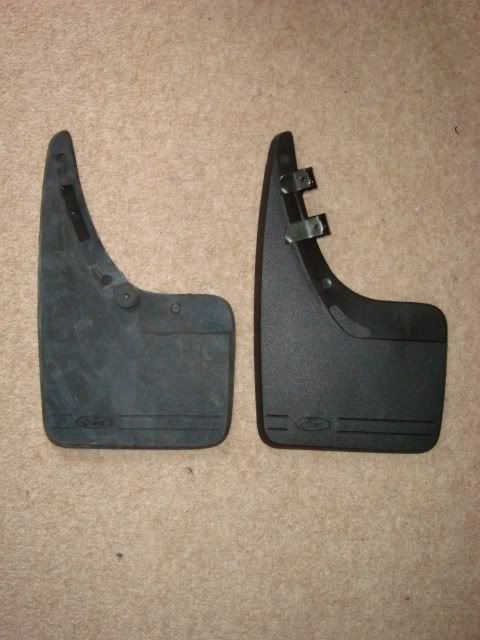

here is 5022356, next to 1052852 - same!
also, 1031188 is the same!
all you have to do is trim the pre-cuts and adjust the clamps and fit at the angle/height that Ford recommend to use them on the rear too
Old Mar 4, 2011 | 05:18 PM
misteracp's Avatar
misteracp
Joined: Feb 2006
Posts: 56
yes, they are EXACTLY the same shape - only the brackets are slightly different
they look alot more classy than the moulded ones and are stiffer due to the metal bracing
