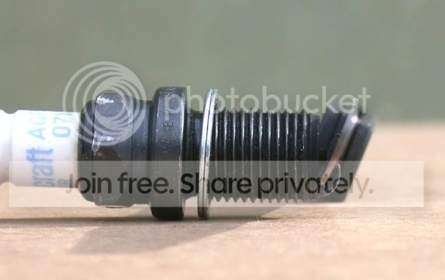

What have you gapped them to mate?.
From what I can remember....
0.70mm will give you a smoother idle but may be a little lumpy higher up the rev range.
And 0.55mm-0.65mm will be slightly rougher on idle but perform better higher up the rev range.
