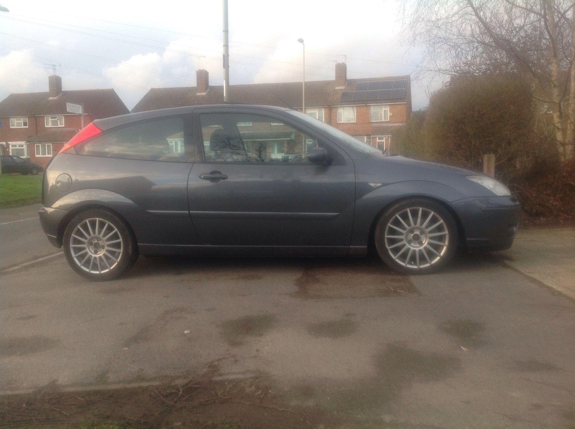

put a level side view pic of your car up

This ok?

thats defo lowered prob why it feels hard

That would explain it.

If it is on coilovers they could be a load of old rubbish but you can at least replace the springs for better ones.
The focus is an awesome handling car and incorrect springs could ruin it, are they coilovers or just aftermarket springs? Either way get something decent and softer of correct spec and you will improve it no end
Its 'defo' parked on a steep slope as well.
Front end is very stiff on these, be hard to tell if yours is lowered/stiffened or not unless you can park it on level ground and redo the photo.

Yes the entrance to my drive is inclined but in my opinion not steep, I shall however measure the height given by 11redex.

Measured the height today and it looks pretty standard so probably not lowered which returns me to my original question, why are the shocks so hard?
