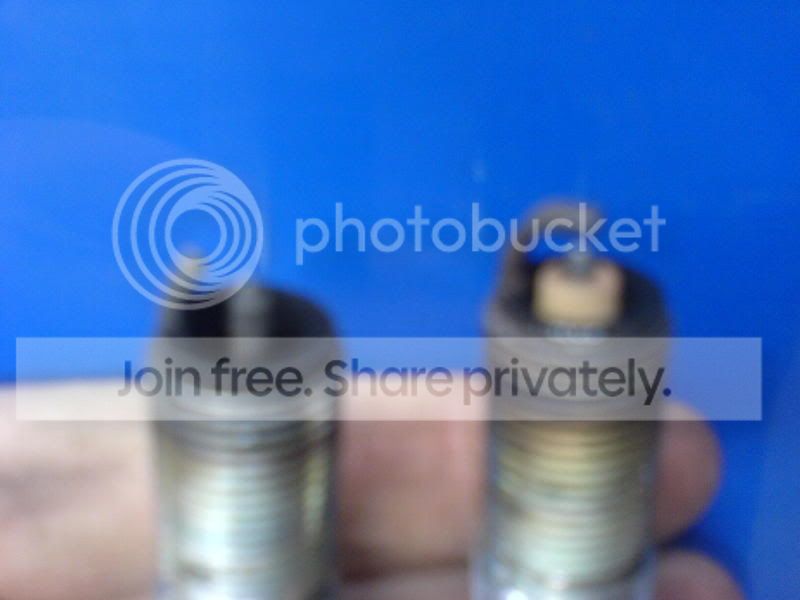

FIXED!!
will put pic up later,
number 3 plug was barley existent,
now replaced runs sweet as a nut

Old Apr 19, 2007 | 09:52 AM
COCHYN's Avatar
COCHYN
Posts: 9,757
Where has that piece of the plug gone? I assume its fallen out, I wouldn't push it much if I were you, if that section of the plug is still there, could cause a problem in the cylinder.
But then again, it may have crumbed in2 thousands of pieces and blown out the exhaust.
Old Apr 19, 2007 | 10:14 AM
zvhrst's Avatar
zvhrst
Posts: 638
From: south yorkshire
i checked bores before putting new plugs in,
nothing there and everything looked ok,
car runs better than ever, i'm thinking its been like it since i piked it up in feb
