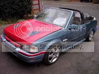

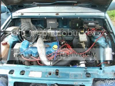

taking the engine out of this
and putting it in this
not to every1s taste but i like it

seems nice enough. just label every connection off the cabriolet loom, and swap the whole loom, as long as you dont go cutting the thing up you wont have any problems, especially if you have both cars together, honestly its very easy and can be done in a day
how long have you owned it? i was sat opposite at a cruise in notts last summer, i was in my red s2...
iirc it had a 1.3 engine in it...
if you need a rst to have a look at if you become stuck, let me know, im only 1/2 hr away...
