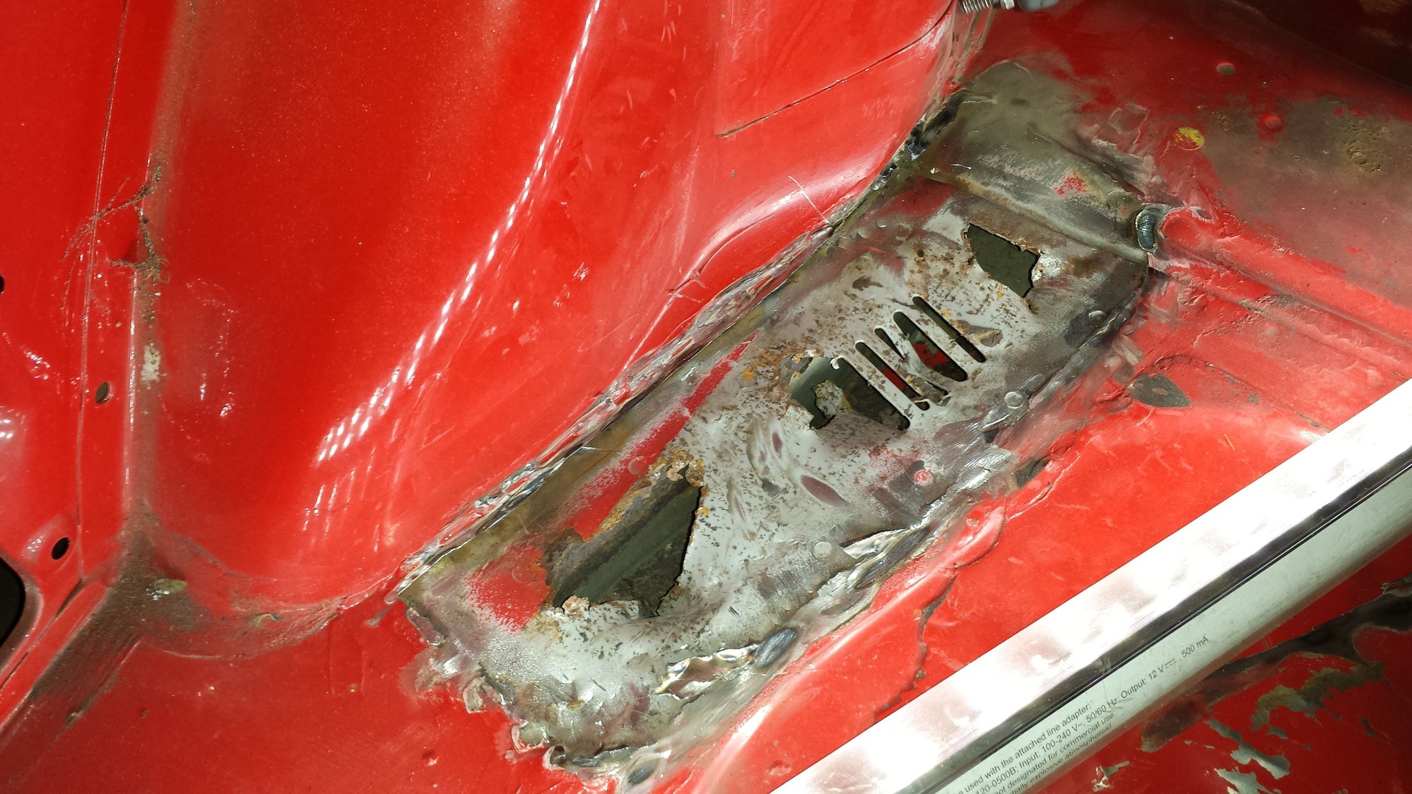

Around window
Been a bodge job previously. Plated over on both sides.
Around window
