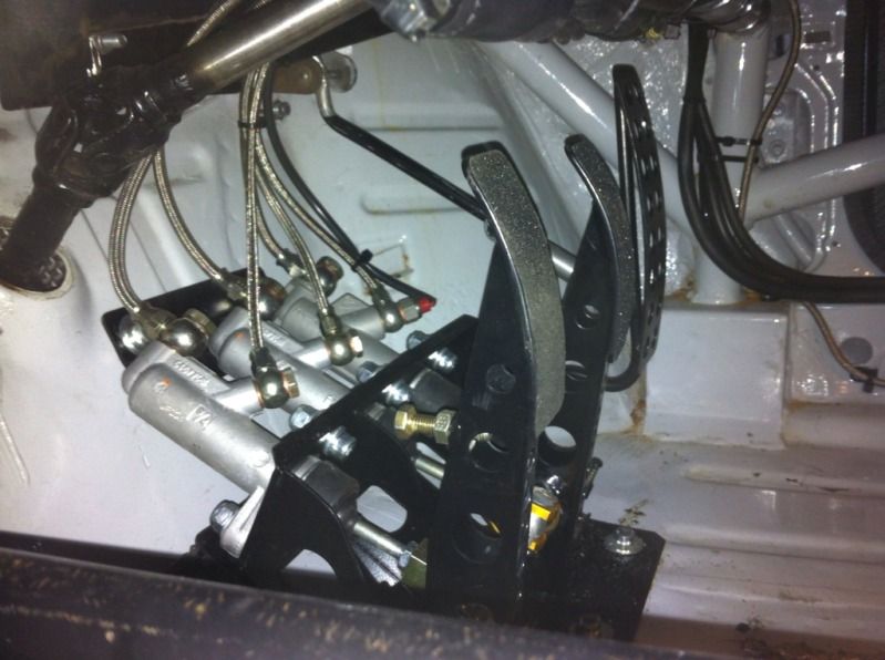

From: essex
obp escort pedal box

I would avoid obp pedal boxes like the plague, we fitted them to 2 cars and had to remove them, the cylinders they use are inadequate causing the brakes and clutch to hold on wreaking 2 expensive ap clutches & release bearings in our case.
The design of the pedal box itself is also very flimsy, the clutch pedal actually snapped on 1 of ours and they really flex if you have to stamp on them hard, imagine if that was the brake pedal and you were coming into a fast corner!

im not using their cylinders and so far have had no issues with clutch pedal
to be fair i dont use the clutch
stamped on brake pedal and all is good so far
not sure if i have a revised edition or all the same

It looks exactly the same as the ones we had many issues with tbh, not just us have spoken to quite a few poeple who have had problems with them, Luke had 1 in his fiesta and took it out.

o dear
it is a stop gap for when i change spec as i want the ap set up

no its for mk3/4

i've the same one ^, i will go for titon one next time

TIlton in mine now ditched the OBP one as the pedal bent and the base where the cylinders are mounted bowed!
