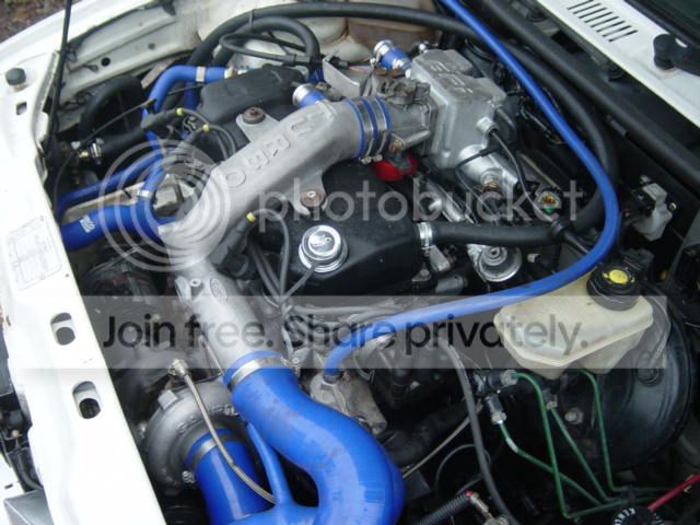

What is the next size down from .63? I'm worried that my engine will blow a piston again because of boost spike, I don't care about the lag because I like it but even with a rr setup and running omex 600 is there still a chance it will happen again?
I was also looking at the t3 upgrade thing on ebay that gives you:
A/R 60 Compressor housing
Backplate (T04B Style)
T34 Compressor Wheel
Is this worth buying?
Thanks Joe

.55 is the next size down but why do you want such a big housing, A .48 can just about make 300bhp what power are you aiming for and what's your full spec mate?
If it's mapped correctly you should never destroy a piston... doesnt matter what management your running!
If thats one of the cheapo chinese ebay turbo's then stay well clear.

Its a s2. And yeah i was running mfi and didnt get it setup haha
I have stage 3 head, newmans cam, omex 600, Fmic with twin fans, cossie injectors, exhaust..
But like i said i wasnt running omex etc when i did it so i wasnt sure if it would be ok when its all setup properly..
Joe
Oh and its not a cheap chinese one off ebay, its a t3 off a cossie just with .63 exhaust housing on it..Whats your opinions on the T34 upgrade pack? its from turborebuild.co.uk
Joe

A T34 is too much for a CVH head on most engines. Obviously there is exceptions.
If you want a larger turbo than the 4x4 T3 Compressor wheel & housing, i would advise the T35 as it is much better design for our fwd setups than the T34 is.
I built a Fiesta ZVH with L6 greys and T35 with .63 and made 320bhp almost 10 years ago now.
