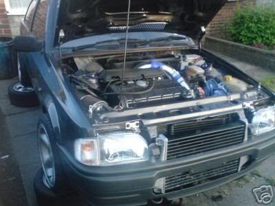

Found these on the net.
Anyone know anything about it?
Probably a nice cost effective conversion - keep the 6 speed box too, think the mounts are pretty similar positions on the vauxhall gearboxes?? Then have a few mounts made up and then a set of custom drive shafts and plumb it all in.
The vauxhall gear linkage wouldnt be a problem to use either as ive seen then used in the XE into a mini conversion and they bolt to the floor inside the car with the selector going through the bulk head.

Great engine/box combination for the money really, although getting harder to find good ones.
Wouldnt you be better putting it in a decent shell like a corsa though, instead of a rubbishy old ford escort? Or do you have a particular fondness for escorts?
Have a fondness for Ford Escorts im afraid! :-(
Got a good one at the moment and I like the idea of something different.
Looking at getting more power (like everyone) and everyone seems to be going for Zetec Turbo's these days but its alot of money to build one and then you have transmission problems on top of everything else.
Looks a really cost effective conversion to me. Just wondered if anyone knew anything about it.

On a like for like 300bhp zetec turbo its going to be cheaper. Internally the LET would cope as it has forged mahle pistons as standard, it also comes with loom and management as standard that with a chip, pressure regulator etc would see 300bhp, again with the right turbo. The zetec needs managment for a start, low comp pistons and rods and valve springs, cams and probably a sutable inlet manifold to even get 300bhp!
You also get the six speed box aswell which is strong enough and wouldnt be eating itself every five minutes.
Im going to obviously price it up and do a few comparisons and see what the costs are - and they will be realistic.

Let standard internals are good for 350bhp safely generally.
pistons will take 500bhp if you want, the rods wont though.
turbo is only really good for 280bhp
the management and loom are fine for 300bhp
