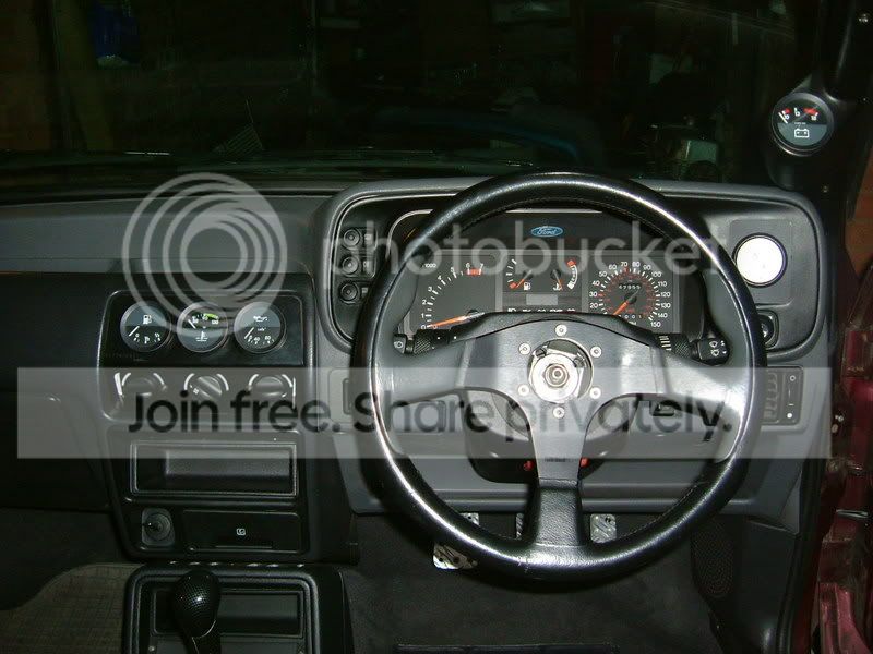

or cossie clocks like ive done?

SaqsS2turbo them clooks look mint Is it easy to do ie plug straight in or does the speedo need calibrating ??

basically u just cut the plug off with the speedo and match the wires the speed is perfect only thing is its one plug instead of 2 like the escort u wil only have 2 or 3 extra wires left out but they are only earth wires for the lighting or doubles wich arnt needed on the cossie clocks

Your cossie clocks look awesome, but i've been trundling around in a bog standard sierra for 6 years now so fancy a change from staring at sierra clocks.
Just another point, how hard was it to rip out the fuel computer and fit a gauge there? unsurprisinly mine doesn't work, so I'd like ideally to whack in an ACT jobbie. You just flush it off with filler, then paint accordingly?

its not so hard mate very easy tel u the truth to get the color right i wud use bumper plastic black spray wich drys out to luk like plastc and use fibre glass from behind as it will be solid id sort ya out but i live milage in slough
to get the gauge to sit right use thin plastic ie dvd case dose the job and fbre glass sits perfect then fine filler the front

Did you remove the dash srround to do it then? It'll be the first job of this kind I'll be attempting, don't wanna cock it up and ruin it!!

yh take the surround off its much easier itsa not to hard i gave it a go and done it one time
