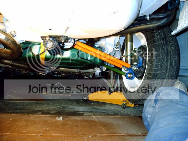

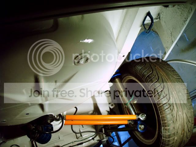

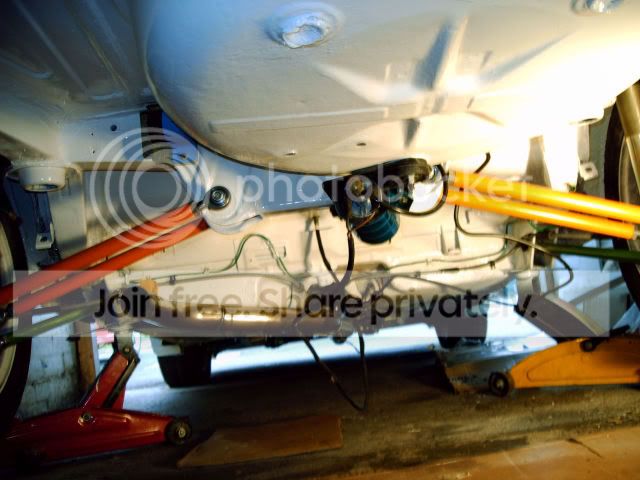

some pics of the mef rear suspension on my s1
Old Jul 27, 2006 | 09:05 PM
smitsturbo's Avatar
smitsturbo
Posts: 7,346
From: aberdeenshire
looks very nice mate is that mef tie bars aswell?
Old Jul 28, 2006 | 06:46 AM
NUTS RuS's Avatar
NUTS RuS
iTrader: (35)
Posts: 15,109
Tie bars, link rods and struts
Old Jul 28, 2006 | 07:25 AM
smitsturbo's Avatar
smitsturbo
Posts: 7,346
From: aberdeenshire
a cheep setup then?
Old Jul 28, 2006 | 09:26 PM
Paddy rst's Avatar
Paddy rst
Posts: 422
From: Newcastle Upon Tyne
aye its mef, and yeah def a cheap set up
