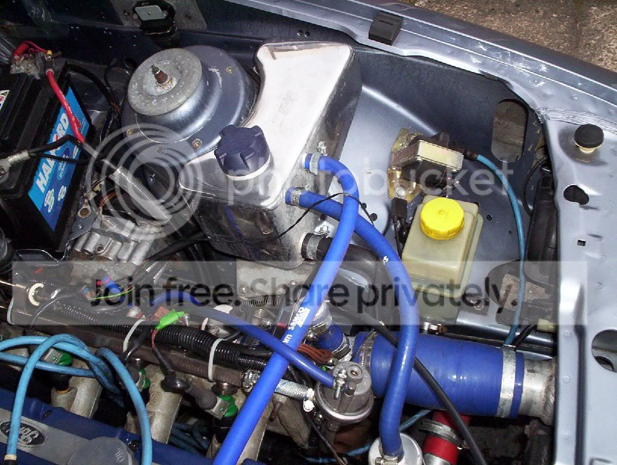

Old Feb 2, 2006 | 07:50 PM
warleydaddy's Avatar
warleydaddy
Posts: 5,893
Theres where my valve was on my saff,and the vacum hose is the blue 1 with the red cable tie round it up by the batt..
Pete..

Old Feb 2, 2006 | 08:36 PM
CosKev3's Avatar
CosKev3
Posts: 3,047
From: Shropshire.
If you look on the pic that Pete has put up above you can see the type of fitting his has,you can fit that type to standard hoses if you want,just cut your hose and clamp in the 'T' piece
