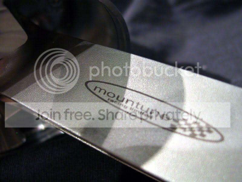

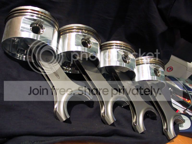

Pauter Forged Chrome-Moly Steel Rods & Custom Spec JE Pistons.
Power wise they will cope with a lot more that I plan chucking at them
A couple of pics...well it would be rude not too

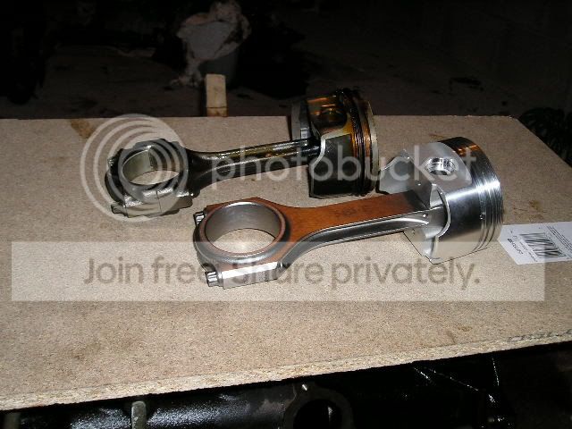

PhilM's Avatar
PhilM
PassionBMW.com Member
Posts: 3,530
From: UK
Eagle rods and Probe Pistons in Josh's engine (shown next to Std Focus items)
Mondeo Rods and XE pistons in mine
