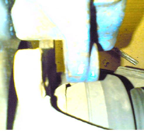

well i have test fitted them to see what work is needed and have come to the conclusion that i need...wait for it.......spacers!! same as 4wd, only difference being that i have to tap the holes in the hub as the calipers bolt into the hub and i need some braided hoses with a right angled connection so that i dont rub on the cv joint rubber boot. you can see the gap in the pictures...

and the gap! as you can see i just need some washers and it also high lights how it bolts
