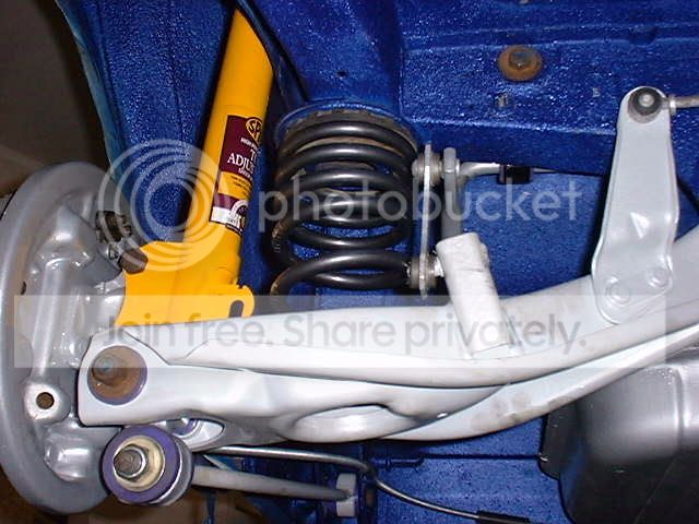

i used rudeys method of the wire brush on a grinder
then seal,stonechip,paint and lacquer
only have pics of stonechip and painted stage though
