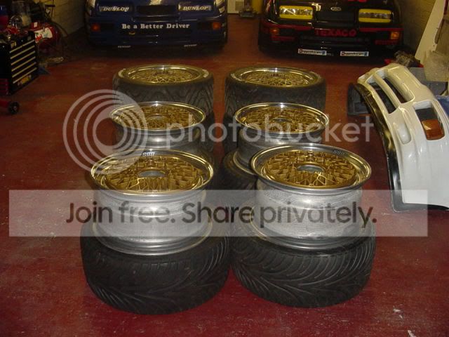

like these but not as wide,

jesus, i WELL want some now! xmas is coming............

martin, how comes yours dont have much of a "lip" on them? can you change the different sized lips. i.e, 1", 2" or whatever all on a 8j rim?

mine are the centre lock motorsport bbs wheels and are 17"x9"
they are a different design to the road wheels to allow for the big race brakes,
and are held on by a 90mm nut.
the brakes only just fit under the 17" wheels which are the max size the group A rules allow,
they look better one the cars

excellent mate, your a star. i was just wondering if you could have less "back" and more "front" lip if you see what i mean. By keeping the same size tyres. i.e, the mounting plate could be flush with the back of the wheel allowing for a HUGE lip if you wanted one.

the centres are the same on all sizes,
the wheels i use are 9" wide but you can go up to 12" width but you will need thunder saloon arches, 9" is the max with original arches fitted.

i see! so all the backs are the same, they just make up the width by putting on wider lips? i was just thinking that maybe you could use a shallower back and wider front and that would make more of a dish like DOO's ones cos yours look more "flat" even though they are wider.

Martin is right (lol ! ) , split rims are a 3 piece wheel , the centre has no discernable offset , the inners and outers are whatever size you require to set the wheel in your arch , in fact almost no-one uses the term "off-set " when talking about wheels , in Racing you ask the "Backspace " as this gives the hub mounting flange to the inner lip of the rim .
By the way wider than 9x 17 is very possible on a std arched RS 500 as i proved with my black car , ive gone for 12's on the new car tho and 290 tyres for grip !!
