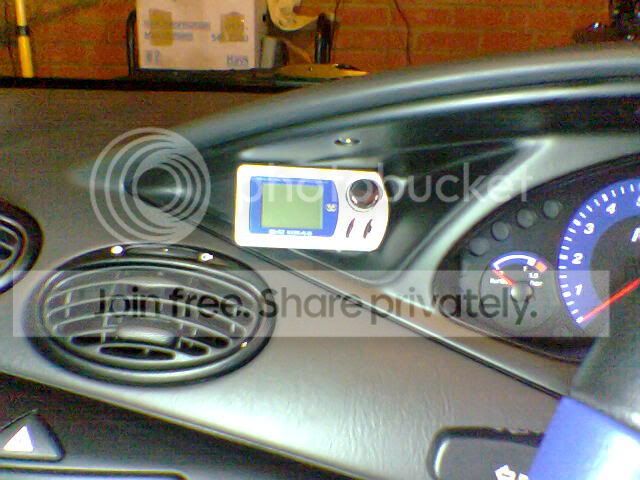

ps must be picture time
post diamond cut wheels
when i bought her
