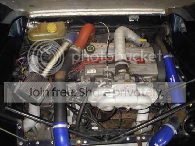

ok guys.
I'm putting together a full parts list for my build and am going to be ordering most of the bits up next week from the web mainly.
Im building a Silvertop 2 litre engine for approx 400-430 bhp
PLease can people remind me if Ive forgotten anything or am dropping any bollo*!!
Silvertop 2litre - got
forged pistons and conrods - will order these as soon as Ive measured the bores - pistons to make 8.5:1 CR
main bearings etc - will order when stripped (does anyone have a cheap source? mahle?)
Focus RS steel headgasket
Reusing my silvertop oil pump (risky I know)
Pectel T2 ecu - got it on car already
Tubular exhaust manifold - getting one off ebay and adapting it
turbo - T04b sorted (I think)
HO inlet manifold
Piper valve springs
External wastegate (will use an adapter on the exhaust manifold
Bailey dump valve
Mt 75 gearbox Ive got
Focus RS clutch??? Im using the stock flywheel
and of course the oil feed and return for the turbo
ok, so what else do I need!!!!!
cheers

erm, re-used oil pump should be fine, certainly no worse than an aftermarket replacement.
T04b from where? not an ebay jobbie, won't last, not seen one do 400-430bhp, look at a gt 3071/76r or a T38.
HO inlet will need work for end feed injectors, unless you've got side feeds for it.
piper springs, get in touch with devil developments instead, seem to have better springs available.
lots of oil for lots of early changes too

I would think you will need a better inlet than an HO item if you want to get the 400+ mark. Ian Howell does a damn fine inlet.

Standard Silvertop oil pump is a risk at that sort of power, ticking time bomb over 400 bhp in my opinion! Keep a bit lower power wise and would be fine.
Unless you force a load of boost down its throat I think you would have to port the head as well. Also an MT75 is a weak gearbox that's well beyond its power limit at that stage. You need a T5 ideally.
A standard Focus RS clutch wouldn't hold up either, you would need paddle and they cost loads, so worth considering a Cossie style Zetec flywheel so you can fit the cheaper Cossie paddle clutches.

yeah, I expect the pump may let go, but nothing ventured, nothing gained and all that!! For me, I would rather just pay out for a YB engine than go to the expense of a dry sump on the zetec.
I will give the head a mild porting, yarp.
As for gearboxes, right , thanks. I will have to look at a T5!! Im hoping with the weight of the car though (700kg) that the box will hold out.
I should have put MTX 75.... is that any better? lol. I know its easily specced to handle the 250hp I have now

Ah right - is it front wheel drive or rear wheel drive? The MT75 is the RWD box and weak. The MTX75 is the FWD box and strong! Lol

Yeah, I was half asleep posting that earlier!! Its a mid engined car running a FWD setup

as Si said, uprated FRS paddle, just got one in mine, about Ł440 delivered, bargain or what :blub:
i need to get mine on the rollers in the colder weather and see how well the HO inlet holds up, got plenty of boost to throw down its neck though.
