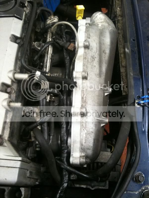

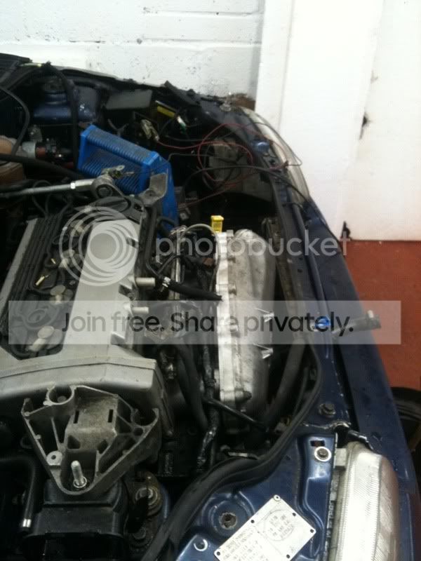

Not going to get the yellow clio done till next winter as Ive got a couple of cars I have to finish before I can start it (my nova and corsa) so to allow me to use my "pikey motorsport" blue clio still this year now that I have sold off my throttle bodies (to help fund the yellow clio) I decided to knock up a new inlet for it rather than go back to a standard one.
I had a spare carb manifold lieing around, and a spare pulsar plenum that Doug (garage19) had previously modified to bend the inlet to it back to clear the ABS on my calibra which just happens to sit it ideally for what I want, and Neil Adams still had the drawings for the spacer and backing plate when we did a similar inlet on his turbo westfield, as he has been selling them to people, so he got another set made up for me as a thankyou for mapping his car.
Adam (aka dewis motorsport) is going to weld me on a flange to take a cosworth throttle body as Ive said I'll map his car as well, so fingers crossed all its going to cost me in actual money is price of a secondhand cossie throttle body for the whole job
So this inlet actually owes me nothing but a bit of time and reciprocated favours which is far more in keeping with my budget theme for this particular car than the throttle bodies ever were, lol, and its coming along nicely so far.
This is how it looks mocked up on the car to check it will all fit:
Could be ran on the standard clio management now too as it can give a map sensor signal like the standard management requires, but im not going to remove my Mtec V4 from it as Im too fond of it and I havent got an emulator to map the standard management with anyway.
