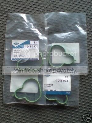

ive got 4, but was told in good faith by a friend, not to use them on my inlet,
rs1800 inlet, and 2.0 mondeo engine,
cheers folks, as this may cure my gay misfire,
also, where do you fit them, between the head annd injector plate, or between injector plate and inlet?
ta

just been on ebay and found them for a rs1800
and they are onn microcat for that engine, so they must be used?

There for the plastic inlet manifolds you see on the 115ps zetecs
They will not fit the RS1800 manifold

as said, they are for the black plastic inlet manifolds
the rs1800 should be a 2 part jobby, a thick gasket that goes between head and injector plate, and then a thin gasket that goes between injector plate and manifold
if you removed the charcoal canister, did you block off the vac hose from it?
if not, that will be sucking in unmetered air
