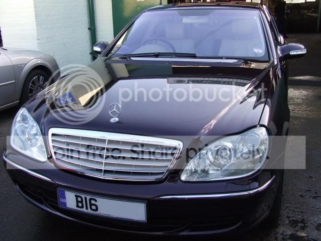

Default polished a merc s600 :D

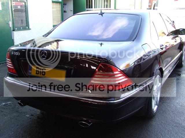

washed with mitt + AutoSmart shampoo
dried with reglaze + aquatouch towel
clayed with sonus green clay
wiped down with autosmart reglaze again

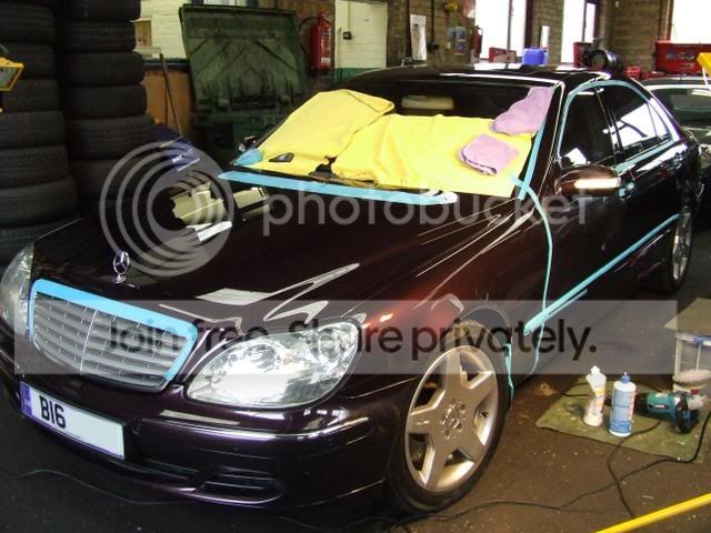

taped up all rubbers & gaps with 3m 3434
makita 9227CB rotary polisher on all metal panels using 3M black polishing pad

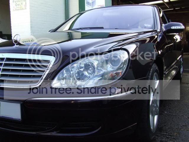

menzerna 3.02 & 3M ultrafine SE polish used

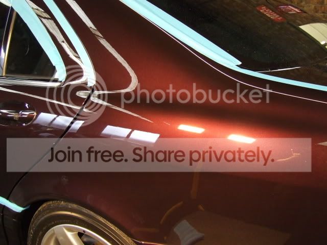

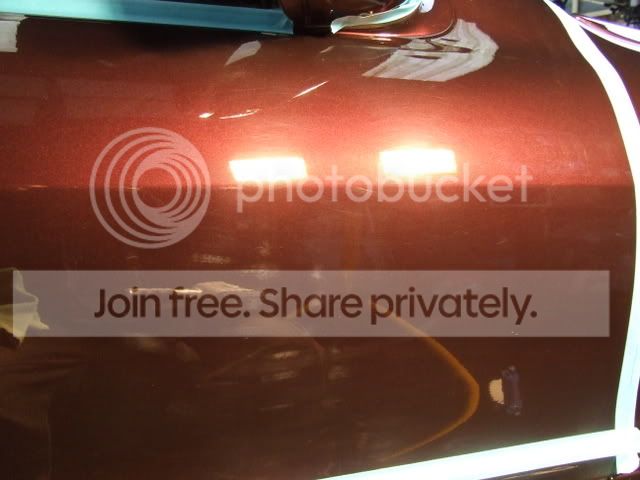

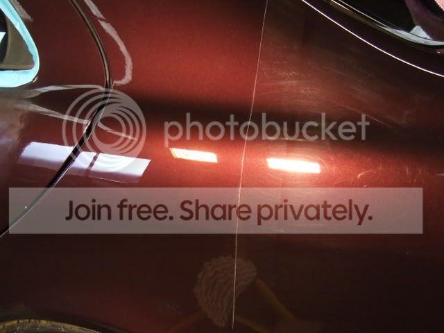

drivers side door before

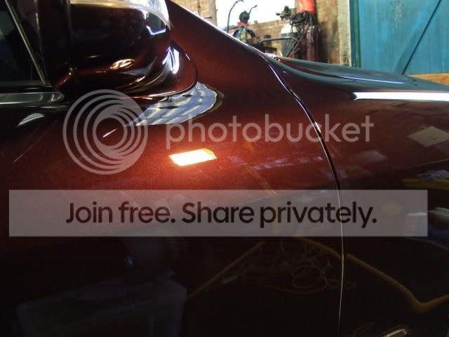

drivers door after

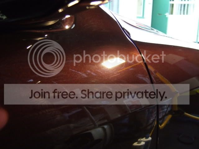

rear quarter before

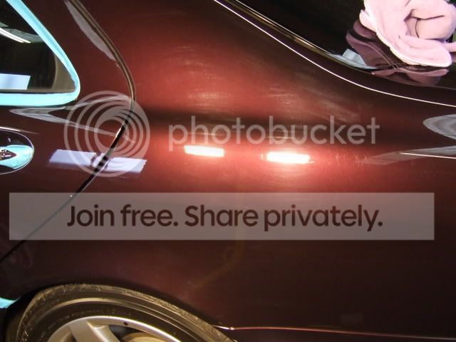

rear quarter 50:50
rear quarter after

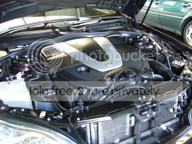

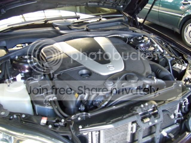

engine bay cleaned with G101 and plastics with Highstyle

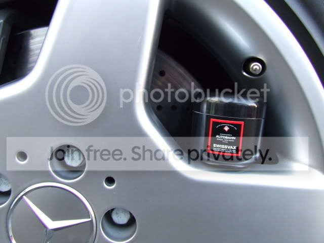

Autobahn on the alloys
Zym0l HD Cleanse
Zym0l Glasur as the wax / protectant
sorry for the crap pics, no sun, so i didnt take many
