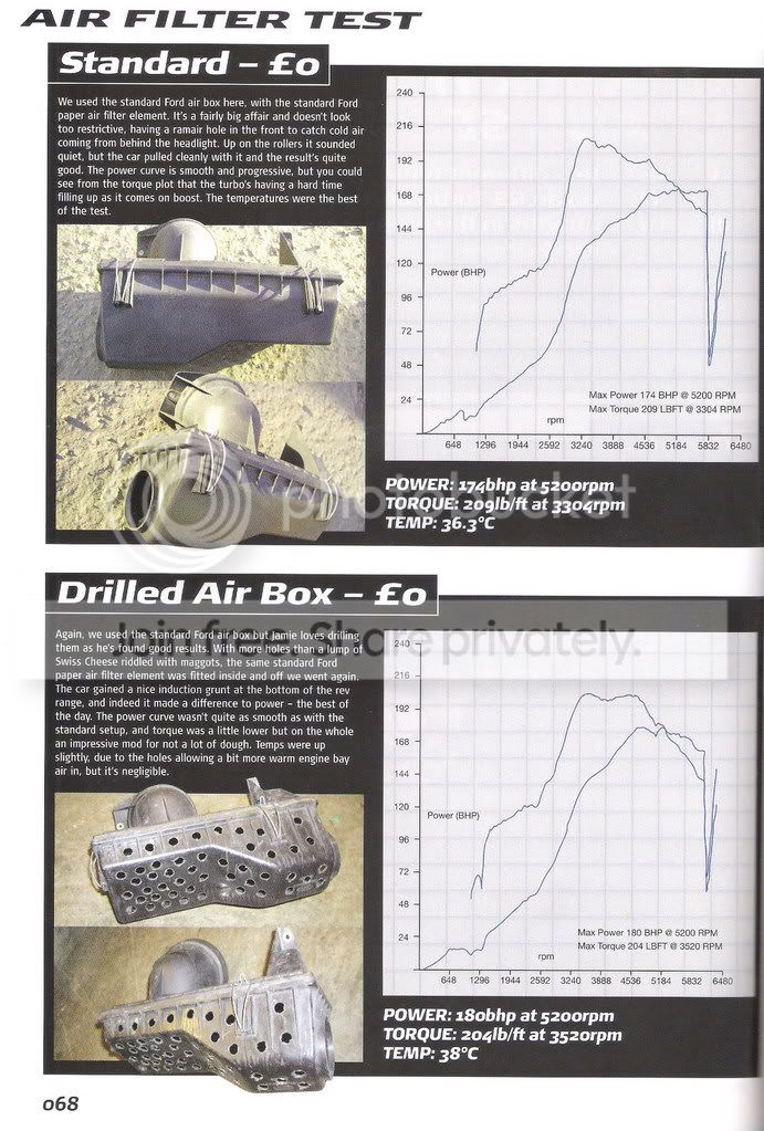

I'm having a discussion on another forum and am being told that drilling the airbox won't improve things.
I know Performance Ford did testing on this a while back and did find improvements but I need a techy answer as this guys being a bit of a plum

Iv,e just had it set up at JAMSPORT where the test for all these induction kits in the mag took place and they recomended the driled airbox.

ok .. get the airbox .. take the top cover off..
totally remove the front part of the top cover ( bit with the hole in it).. job sorted not drilling required ......
had mine like that and it worked perfectly running at 22psi on the track much neater and stops loads of hot air entering the air filter
had an act guage in the air flow from the metering head and the temps were alot lower with the box than the cone

sooooo
if your drilled box sucks in less hot air than the std setup you will make more power
