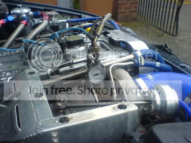

Alrighty folks!
Just looking for a bit advice really on my friends Escort.
The bottom end had been rebuilt and has done its running in miles so we changed the oil today and thought we would check the oil pressure as it always seemed low on the standard gauge.

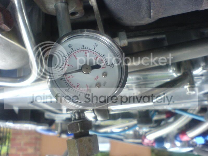

We checked pressure before we changed oil and the most we could get was 2.8 bar no matter what revs or what temp that the max we could get.
So.....we changed the running in oil to 5w 50 fully syn and tried again.
Pressure increased a wee bit to around 3 bar but no higher.
We let the engine idle and the oil come to temp a bit and then held the revs at 3k and the pressure dropped rather than rose?
What are next logical steps for investigating this?
Our temporary test set up.
I take it this is an ok place for measuring pressure?
pressure while holding the revs @3 k.
Cheers

I would say it is not a good place to check pressure as its flowing rather than holding the pressure imo
That would explain the drop when revs rise,cos the pressure will drop at gauge due to the turbo flow

costina, that makes sense but I have my oil presse sensor at the the other end of that line on my car with no troubles.
Steve...im not sure what diff that would make? I thought pump created flow not pressure

[quote="rapidcossie"]costina, that makes sense but I have my oil presse sensor at the the other end of that line on my car with no troubles.
euan does your gauge have a tube to it?? just thinking the gauge is too near the t piece
My cos has done 108 k on std bottom end 60 psi cold 30 psi hot using 15/50 mobil 50 psi while driving

Thanks for posting this up for me Euan. Its been anoyin me all nite now.
costina
All rite mate, why does it make a difference where the guage is? Surly pressure is constant throughout the engine?

The gauge thats attached to the engine, does the oil pass through it as opposed to flowing to it as an in car gauge would, just woundering if that makes a diff to the pressure reading.
Steve.
Just thinking cos its a short path to the gauge its not getting enough pressure cos its just flowing past????? the oil from turbo goes to sump flow only,were as when its at the block the turbo is a restriction creating pressure if u get my drift
IMO your only getting flow not pressure

That oil feed line going to the turbo comes from the side of the block and the low oil pressure light on your dash is on the same line( on the block that screws to the engine block)
My oil pressure gauge is an SPA one which has an electronic sensor and capilary tube etc..

OK sounds strange imo i would put the mech gauge were the std oil sensor is for gauge and light and see the reading,unless like an spa which is good quality i would stick to a mech gauge as even the std ones are poo and rely on good wiring etc

Prob is on a 4wd car its vey hard to get to block that attaches to the engine block.

What is the next step tho mate? other than changing pumps etc.
I know what your saying bout the posistioning of the guage but personally i dont think it makes any difference. Not a dig or anything.
So what else can cause it?? Cant be worn shells, anything else??

ok as i said us a mech gauge at the block to be sure the dash one is correct, std pump pressure is around 60psi cold high pressure 80 ish
How was the engine run in ???? miles type of oil etc
