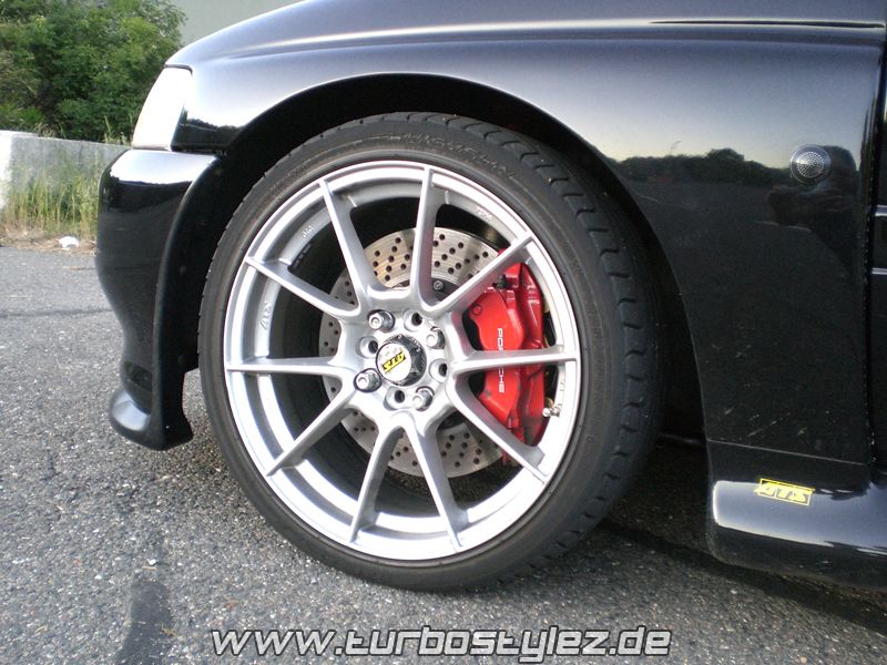

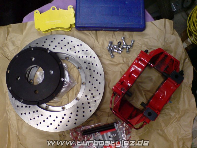

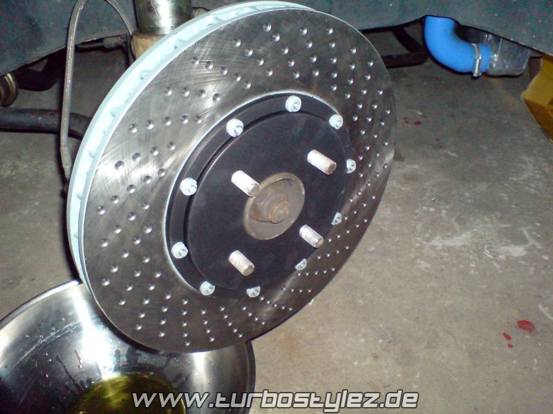

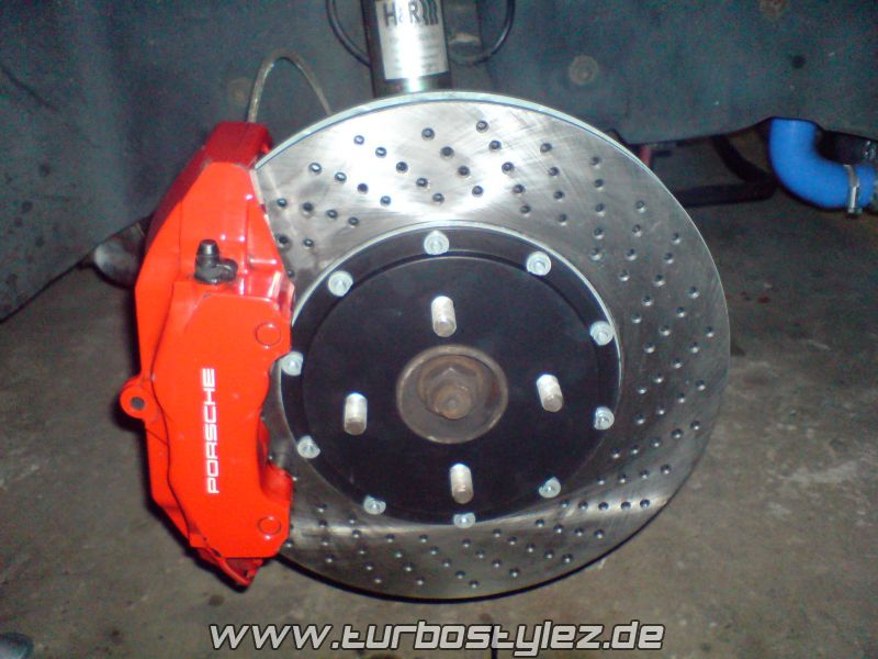

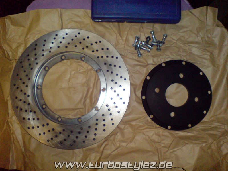

Slowly, but there is an evolution

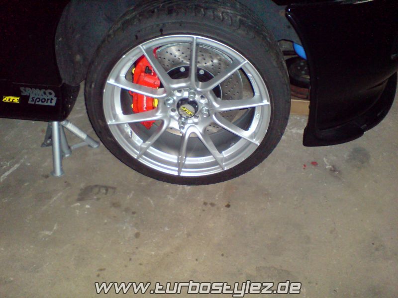

new front brake:
Spec: Porsche GT3/Turbo 4 pod saddles, EBC Yellow Stuff Pads, Porsche biTurbo Discs 322 x 32 with new cnc machined bells
new Front Diff with new driveshafts will be mounted soonest.
A bigger oil pan from R and B Motorsport comes to the round!! (cheers Mike) I also got his old breather system.
After that the car should be a RING-fit and I am looking forward to the new season coming along....

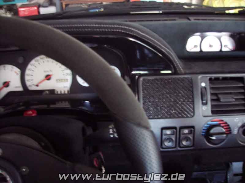

I will post some more interior pics tonight, from the doors, dashboard and roof!!

Awesome car i like the porsche braking setup is that from movit??
Do you have any other plans for it?

thinking to mount the gierling 4 pods with 280 x 26 mm discs to the rear and get an new handbrake with adjustable balance.

thats lovely mate..any close ups of them alloys as they look like the new focus WRC alloys
Old Feb 13, 2007 | 07:13 PM
- Sim -'s Avatar
- Sim -
Posts: 544
From: Jülich / Germany
These are ATS Rims,
often used in motorsport endurace races on the ring.
here, but with the old brake setup:

Really nice escort cossie mate!! very different but i like it a lot especially the interior stitching etc.
