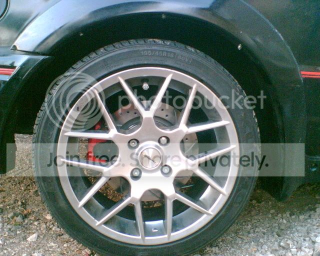

Heres mine, i bought them second hand so i wasn't so in the dark about it all. As you can see mine are countersunk, (which they have to be to clear the hubs)

sexr3i the only thing i would say, is those brackets look incredibly thin
Mine take up the whole clearance between the hubs and the carriers.
