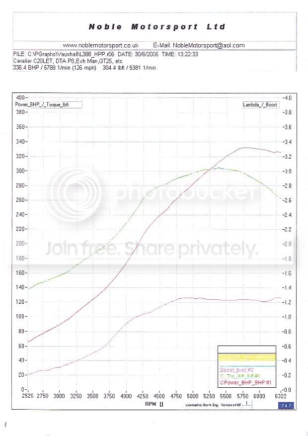

anyway what i mean is i hear lots of you (yb's)running 22,23,24-27psi of boost and only making between 300-350bhp maybe?
thing is i made 336bhp with only 17-18psi which is great. however i wanted more power
my mapper says he can't fit anymore boost in,as it starts detting.
he says i need to lower the C/R before he can do anymore!
so by lowering the C/R and then returning to the same boost will i have less horse power than before?
effectively needing more boost to make the numbers?

Depends on turbo and injectors really!

as in, a smallish turbo needs to make more boost to flow as much air as a bigger turbo?

Lee there has to be more to your lack of power(unable to get power) problem than just comp ratio. A local lad round my area has the same turbo as you and on a std inlet is running 398 on 1.4 bar,i'm not 100% on his comp ratio though but i'm pretty sure its still in the 8's. How is he able to fit the boost in without det'ing?
Robbies LET made 530 on 1.2bar(gt35r) and Adaptec made 400hp on 7psi. I'm sure the LET is just as good for big power as the yb just seems everybody prefere to use what be tried,tested and race proven

we've put the problem down to me fookin up basically, i changed my spec on accident or by my lack of knowledge. i had a measured 7.9:1 C/R but then i had a head skim and reduced head gasket thickness it may have been that more got skimmed than i knew, and we're estimating C/R now to be 9.0:1

9:1 is fine mate,just move to solids and rev the nuts of it
No wonder its making good power on low boost eh
