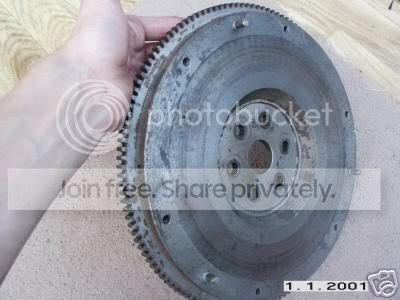

Need some help guys ive been offered a lightened and balanced flywheel for an S2 RS Turbo but i havnt got a clue if its legit or not looks like any other flywheel to me
What differences should i be looking for?

A Lightened Flywheel will have a fairly large amount of material removed from the back, but if you have not got a standard flywheel to compare to, then it may be hard to spot. A Lightened non-EFi flywheel ought to weigh something like 5kg I would have thought, so there's another way.
Alternatively, post a pic of the back of it (not the friction face).
How much is it anyway? As I can get them done fairly cheaply.

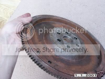

Heres some pics
he wants £40 for it ive been given a brand new unused AP racing clutch for an S2, just need to get a flywheel to go with it

That looks like a standard one to me, is it just me or is there still numbers stamped in the back? These wouldnt be evident if its been machined.
However, if you're looking for a flywheel i will have one spare in the near future as im converting to EFI. Depends how quickly you need it?
