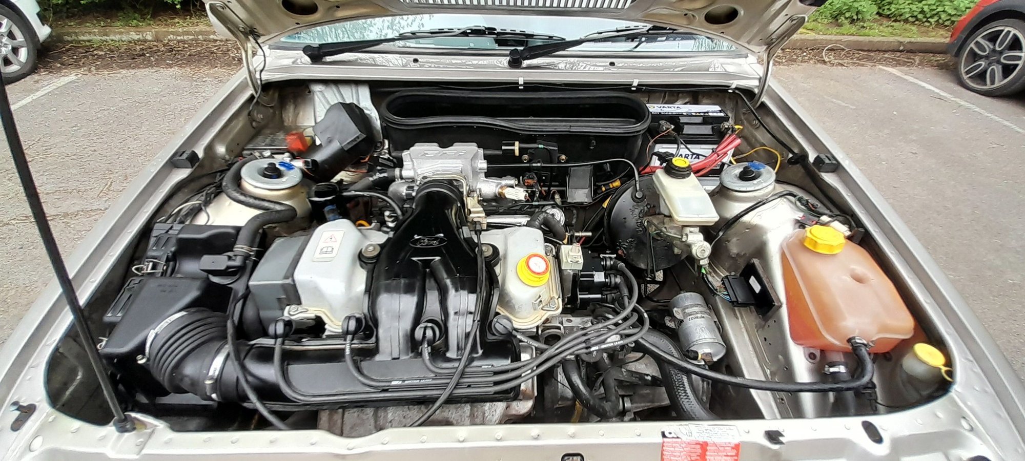

Can anyone tell from the photo if the car has abs fitted or not as I need a clutch cable and there are different size if with abs apparently.

That looks like a non ABS master cylinder to me.

Non abs fluid reservoir, so agree with boost monster

Cheers guys, I was thinking none abs as I can't see any pump or the belts for abs system.
