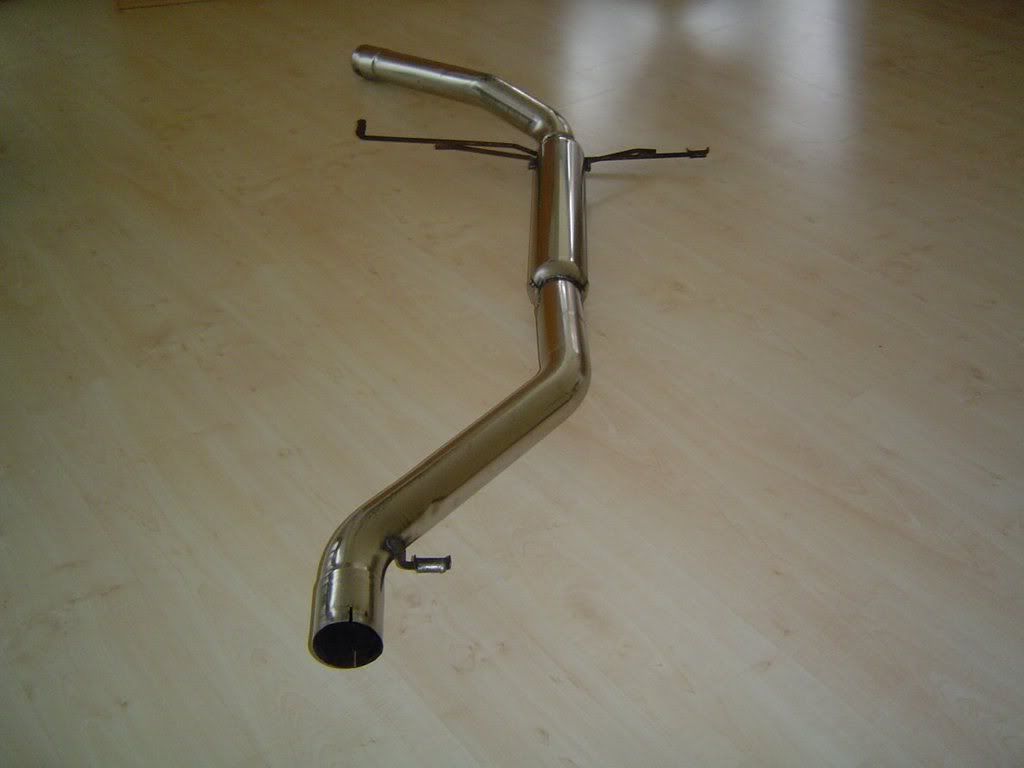

Today I have sandpapered the downpipe by machine and after that polished it. Again, not concours condition (like Bartjan his exhaust..) but it will do for me. And as you hardly can see the downpipe when its on the car, I think this result will be ok:

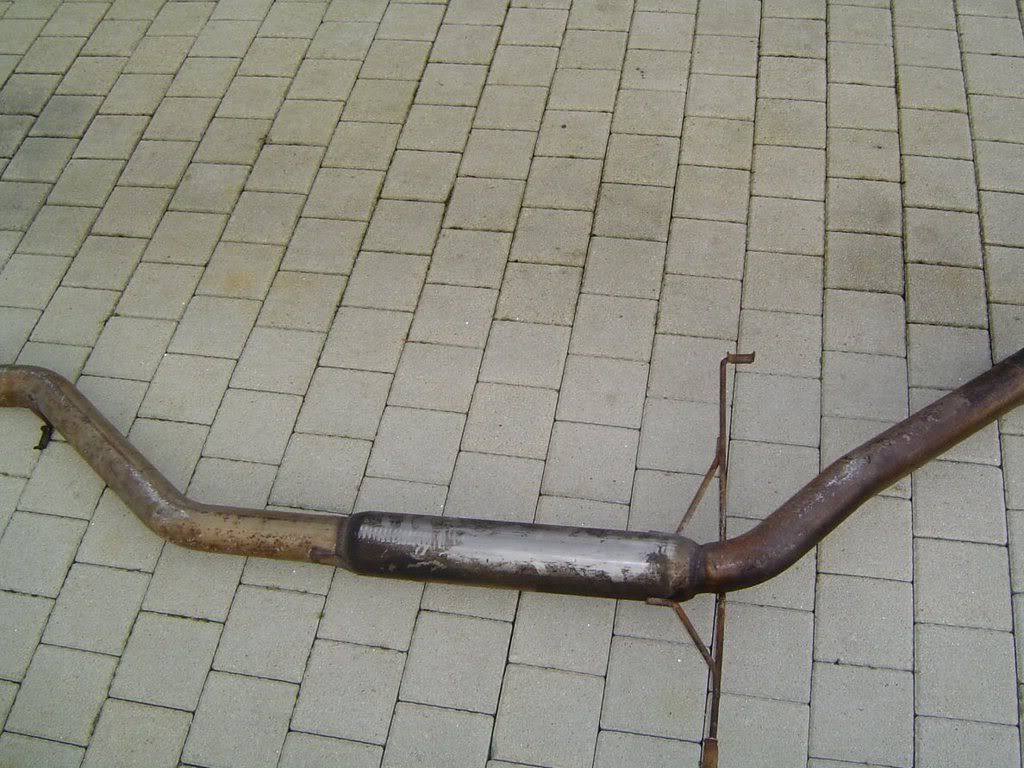

And finally I had to do the biggest part of all, the middle section. This is what it looked like before starting:
And after sandpapering, polishing, some good old Autosol and a lot (!) of elbow grease the endresult looks like this:
Only thing that remains is painting the brackets nicely black. I am very happy with this endresult, so when all the salt from the roads and bad weather are gone the full system can be put under my car. Cant wait!!
