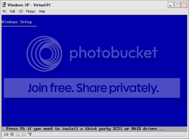

ok .. got the following ..
asus p5p800
80gig sata h/d
1 gig memory
but .. someone said i might have trouble loading xp as i need to load a raid driver ???? erm ..
also how the hell do you decide what cpu to use .. as this mobo has a few issues with certain intel p4's...
i need to know what bios i have to decide on what chip i can use ... but i got no idea .. cant get a p4 cheaply enough to just try it ... but i can do a bios update but need to get the system running first .. bloody catch 21 then
any ideas???

Pete,
At the start of installing XP it say's press F6 if you want to install a third party raid / scsi adaptor
As for the board, go for a cpu that doesn't have issues for a start then run a bios update if you want.
Search the net / forums for conflicts with that board and cpu
Again, option B) Bring it to Kent

Originally Posted by DanRSturbo
Pete,
didn't bloody know that at the time did i
just was told its a good mobo ...
was lookin at a 530j p4 but that has issues with some bios
ok its a rev 1.01
do i need to have a seperate disc for these drivers dan ??? or will it be on xp ??

You will need to have seperate drivers to install it if it's the one you are planning on putting XP on it
