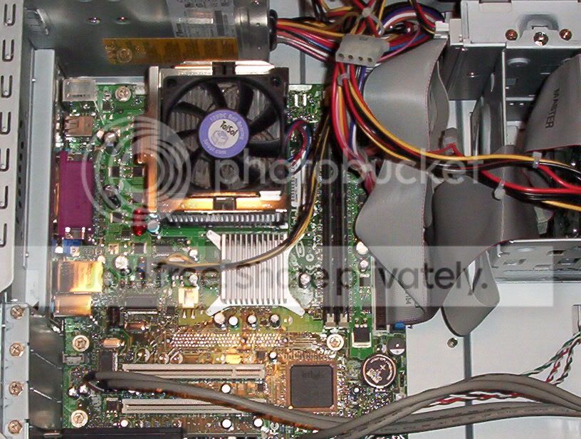

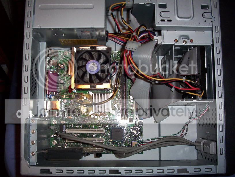

ok all i know about my pc is that its about 2 years old, 2.6GHz celeron, 512DDR RAM but upgrading it to 1 gig today, sound card and graphics card are stock at the moment but havent got a clue how upgrade friendly my motherboard is, not sure if you can tell me just by these pics? and also whats the best graphics and sound i could get for it? it might be that you cant tell me anything but im sure you could tell if its ripe for some new gear or whether id need a new motherboard.............

I cant see an AGP slot there and you've only got 2 spare PCI slots which makes your motherboard pretty limited in upgrades Im afriad.
What are you trying to gain from upgrading your pc? Is there a particular task you find annoyingly slow?

Most graphics cards use the AGP slot (and newer ones also use PCI express now I think - which isnt the same as PCI) - which yours doesnt have.
PCI slots are those 3 white slots at the bottom of your case of which one of them you've already got occupied with a modem? You use these slots for pretty much anything except graphics cards! You can get PCI graphics cards but they are not that common and I dont think they are all that powerfull because of the limitations of the actual slot.
