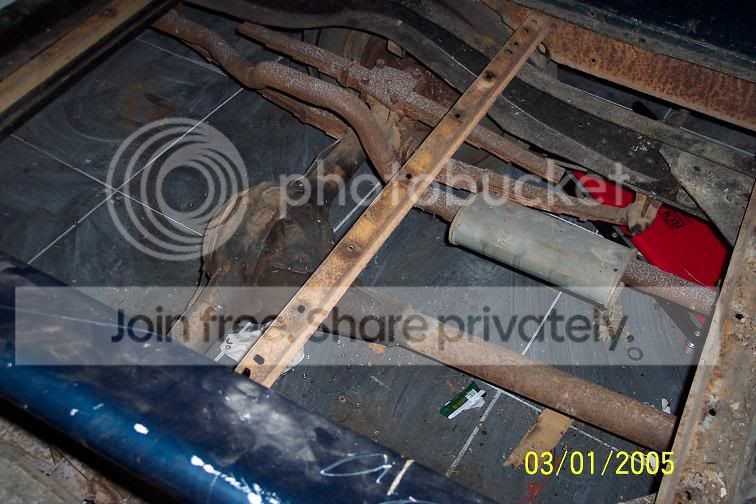

is how it started, engine and box missing all standard.
then I stripped it out, found minor rust, not bad for a 53 year old truck.

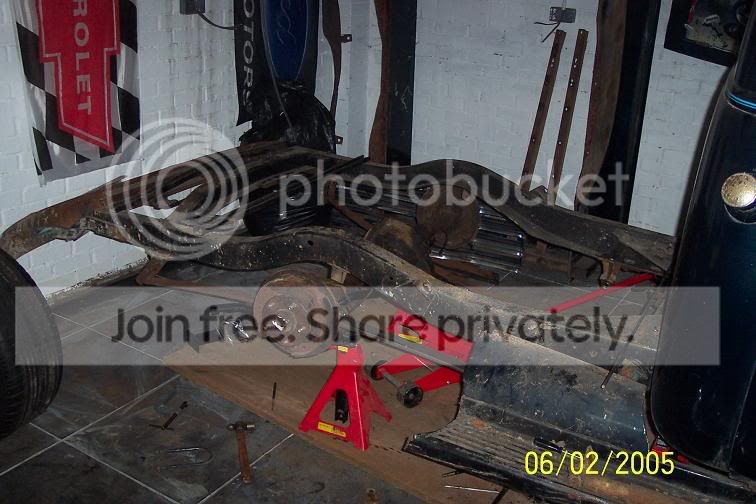

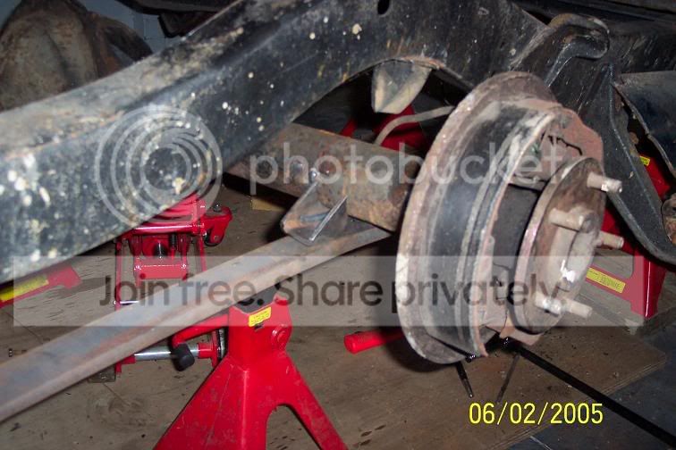

Next I decided to start with the rear axel, I got some mono leaf springs from a mate and a Trans am LSD axel from another. I had to make some axel mounts so the TA axel would fit. getting the old ones off was a bitch, but thankfully my wife bought me a 9inch angle grinder for Xmas - problem solved!!
Next problem is the 3 inch U bolts needed to secure the axel are too long so I'm having some made from 12mm bar, then at least I can get her back on the wheels and see just how low it's going to be.

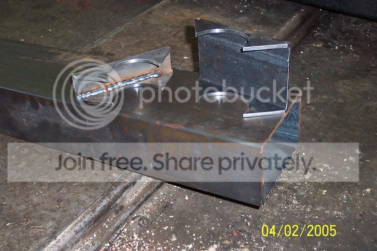

Evolution af an Axel bracket.
I could have been rolling again if it was not for this cock-up.

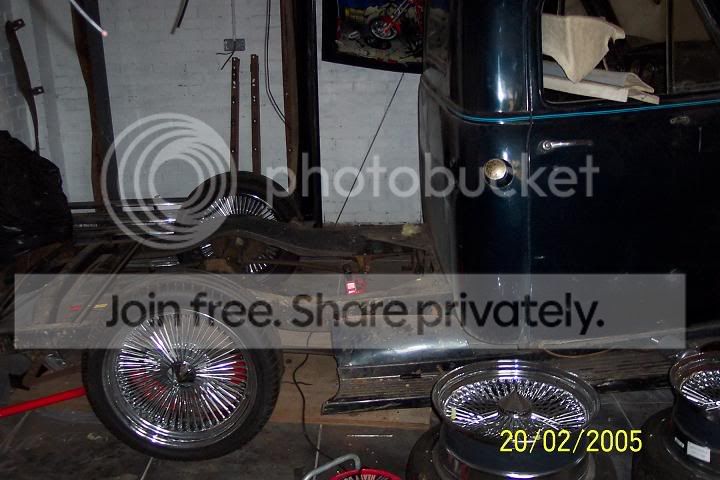

Quick preview of the wheels, these are the fronts, they're 18's. the backs are 20's all rolling on 245's

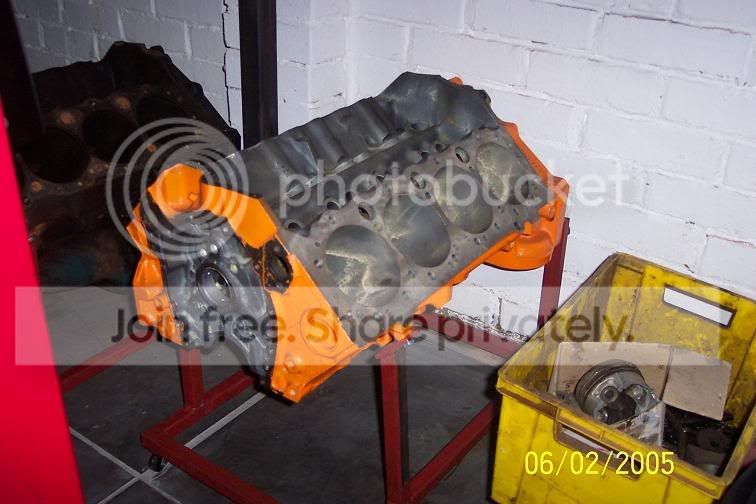

350 / 5700cc chevy engine all machined up ready to go, all it needs is a good clean. Yes, that's going t o be the trucks colour!

I'm just waiting for the rear axel U bolts to be made, I'm hoping to get them for next weekend. At the moment the only thing updated in the garage is the roof, I'm insulating it. I'm sure no one is interested in that!

Done some minor work today.
I got the 4 U bolts to hold the rear axel in and got it all bolted down. Put the rear wheels on and let her roll again.
Think I might have got carried away with the lowering! Probably going to C notch the chassis for clearence now.

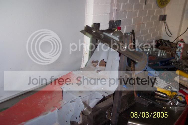

Been a little busy making a jig to duplicate the geometry of a XJ Jag, I figure it's a big car, PS, 4 pot calipers, vented disks - just what I needed really.
In reality it's a fookin ugly subframe, not to mention hard to find in good condition!
The one I got was holed, I could have welded it up but what's the point?
So I got some 80x40 and set to, made some guide tubes and this is what you get!
Next to do is make some mounts so the rack mounting points can be taken.
Just waiting for those tubes to be made.
That's the drivers side, note the rust.
Not very interesting but I'll show the mistakes too! but hopefully there won't be too many of those.
